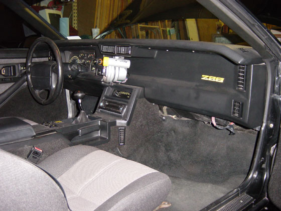

My car isn't a firebird, but I had no problems.
