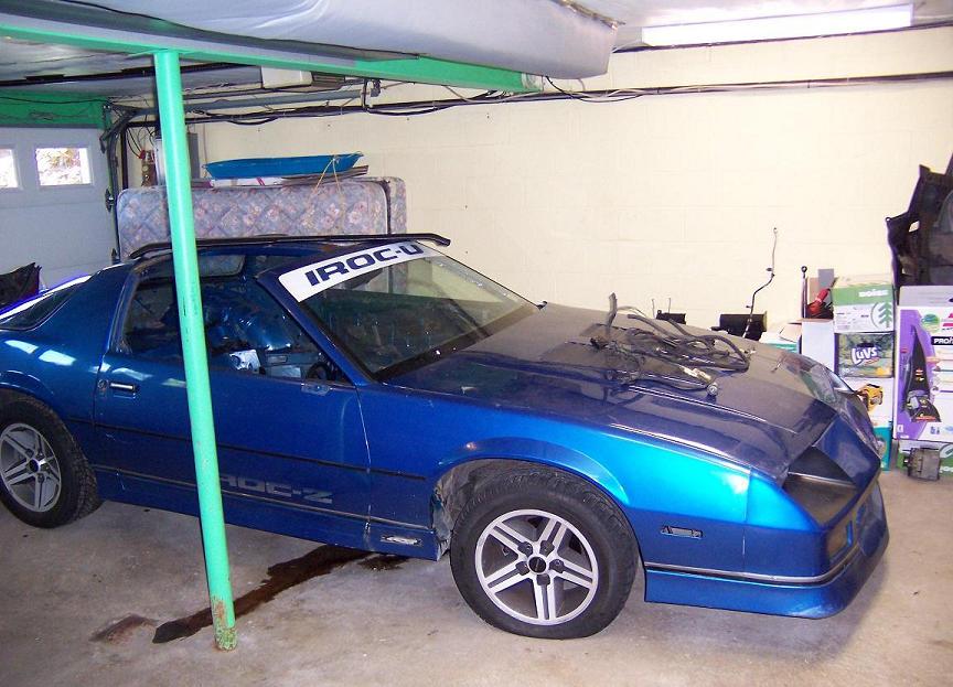

here's a pic of the future car of the year in 2006!!! ha ha (hopeflly..)

as you can see, the car is completelt gutted..... just need those pieces out asap. thanks
