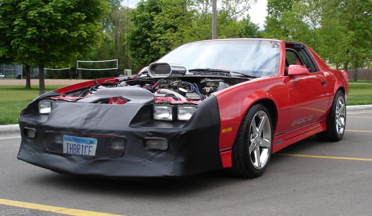

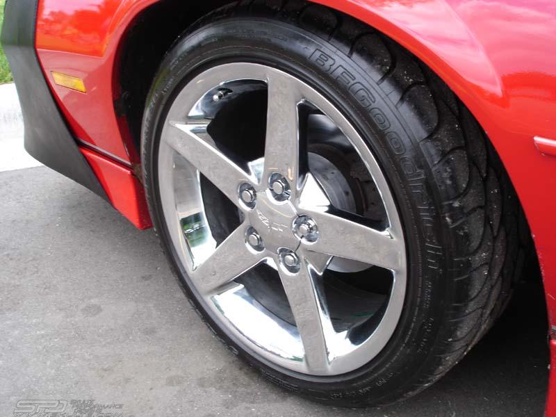

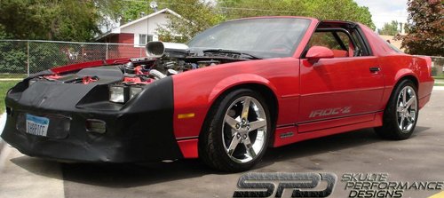

Old Aug 2, 2005 | 09:00 PM
Gunny Highway's Avatar
Posts: 2,467
From: The nation's capital
Car: 91 RS
Engine: 350 TBI
Originally posted by askulte
From what I've read the actual C6 wheel sizes are:
18x8.5 front (GM 9594351) 58mm 6.53" BS
19x10 rear (GM 9594353) 79mm 8.11" BS
The 2" adapters will work for the 8.5" wheels, and if you have real C6 (not C6 style imitation wheels, with a real C6 offset) 19x10" rears, you can use our 2.25" billet adapters. I've seen a lot of places sell C6 style wheels with the C4/C5 offsets, too, which is what the wheel specs you posted seem to be. I hope this helps!
Any more pics of that car?

Who says you need a lipped wheel on these cars?

Those wheels look pretty sharp. I was afraid the lack of a dish would hurt the appearance of those wheels on a 3rd gen but it appears that isn't true. I have to admit that I really find humor in that license plate.

he needs some C5 brakes and rotors on there. With those kinda rims, you deff need to show off a good set of rotors

Damn you Andris.. always jumpin on my Ideas.. was just about to come to you for a set of billet adapters for C6's . I was expecting you to say "Well Goku, i've never made any for them, and i've not seen it done yet... thats going to look badass"... but no.. instead.. "oh yeah.. C6's.. yeah i've got a set on my daily beater.. . J/K, they look awesome, was going to inquire about these rims though.. will you make the adapters for those, (same wheels you have but the black ones assuming I can find them), and whats the cost ?

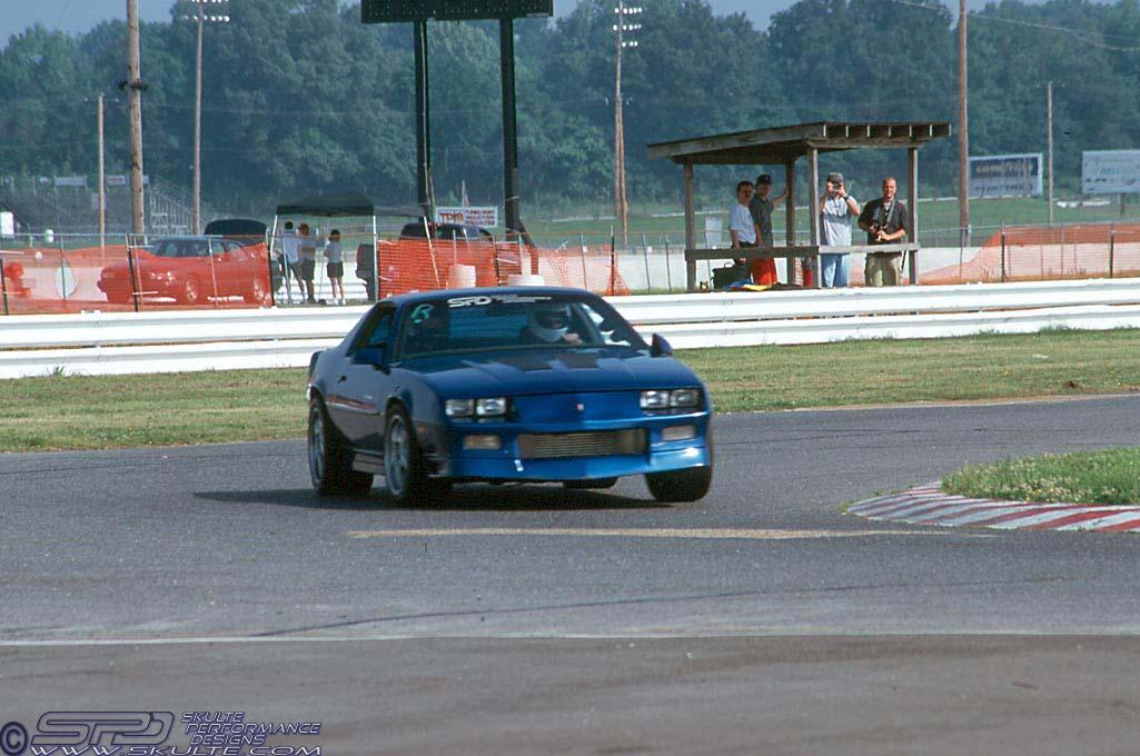

Heh - Omnipotentgoku, that's not my car. Those pictures are from my customer web gallery at http://www.skulte.com/gallery/view_a...Customer-Cars, and that it Matt Ringsmuth's Camaro with the C6 rims.
This is my car:
I've got Z06 rims on it now, and some CCW 3 piece wheels for the track.
