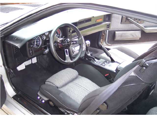

Spiffed up interior.
JamesC

Many thanks for the kind comments.
Engine specs:
Bore x stroke: 4.00x3.48
HP & Torque: 330 hp @ 5,000, 380 lb-ft @ 3,800
Compression: 9.1:1
Block: Cast-iron four-bolt main, one-piece rear seal
Crank: Nodular cast iron
Connecting rods: Powdered metal forged steel
Pistons: Cast aluminum, dished, 5/64-inch rings
Camshaft: 212/222 degrees @ 0.050, 0.435/0.460-inch lift
Heads: Vortec iron, 1.94/1.50-inch valves
Rocker arms: Stamped steel, 1.5 rail type
Intake: Dual-plane aluminum
Carb: Holley 600 cfm, vacuum secondary
I enjoy the stock appearance of the car, but here's the rest of the story:
GM lightweight flywheel, CenterForce II clutch kit, Hooker headers, Catco hi-flow cat, Hooker cat-back, GM dual electric fans, T5 with B&M Ripper and Hammer shifter, Energy Suspension motor, tranny, secondary crossmember, torque arm, bump stops, and tie-rod boots, Prothane A-arm bushings, Global West steering box brace and subframe connectors, Hotchkis tie-rod sleeves, Spohn 1LE front brake kit, PBR rears, Earl's braided-steel brake lines, 1LE sway bars with GM poly end links and Top-Down Solutions greaseable 36mm front and Energy Suspension greaseable 24mm rear bushings, 1LE aluminum drive shaft, Edelbrock torque arm, Spohn lower control arms and panhard, Summit differential cover, 1LE 10-spoke aluminum space-saver spare. Lear/Seigler Conteur driver’s seat, overhead console, 145 mph speedo, MBA billet pedals, Alpine CD player and Kenwood speakers, Grant Signature Series steering wheel with black billet sleeve and silver 'Camaro' horn button, and **** mirror (auto dimming, temp, compass). Sylvania Silverstars. Propart clear side markers.

Such a beautiful car! What kind of seats are those?

The driver's seat is a Lear/Seigler Conteur, found in some early 80's Camaros. It has thigh, seat, seat back, and lumbar adjustments. It also sits on a six-way electric track.
