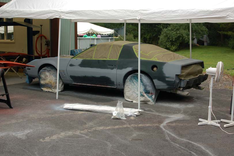

Well, we painted the car under a canopy, but I won't lie, a few bugs did decide to land in the clear before it had dried. With the exception of a very few, they all came out when we wet-sanded the car after the clear dried. Actually I'm really amazed with how well the car came out being painted outside, but we didn't have a booth, so we made do with what we had
Here are a few pics of the canopy, etc:

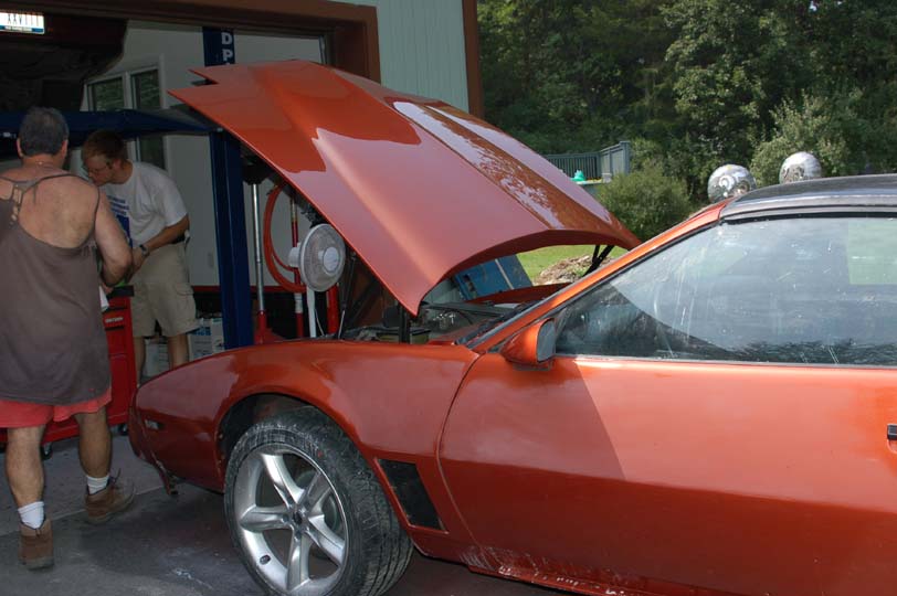

And of course the wet-sanding afterwards

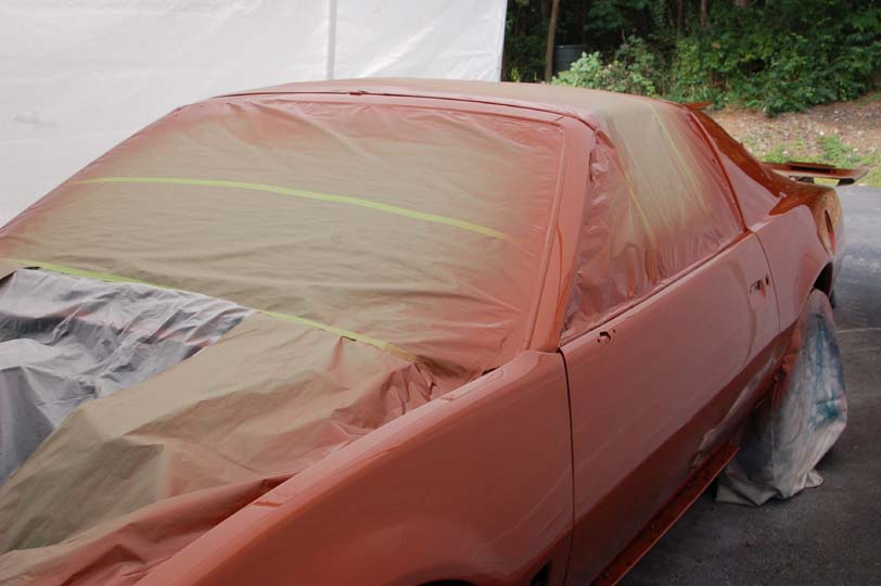

Finished product (not completely buffed though!)
We spent a whole week on the car...only about 5 hours of which was spraying color/clear...that includes the time to clean up after the spraying. It's all about the prep, take your time with that, get everything straight and properly prepped and you will be very happy with the results!
