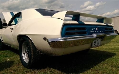

i know its an old post but you seem to be rather confused friend,do you know what doesn't belong?
the 69 trans am spoiler on the z28 doe not belong,its a frigging sacrilegious thing.the difference
between your opinion and my facts are what they are.
a visual clue or two might help you grasp your error:
1969 trans am,view the spoiler please
1986 trans am,view the similar spoiler to its older brother,the 1969 trans am.this is were the spoiler originated and its were it truly belongs.just because gm engineers are stupid doesn't mean they are right,does it.
