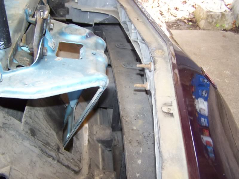

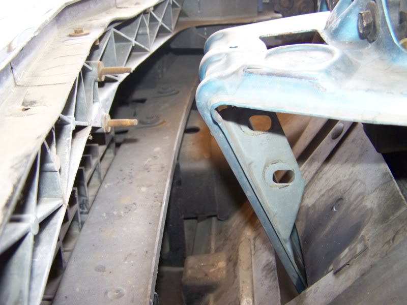

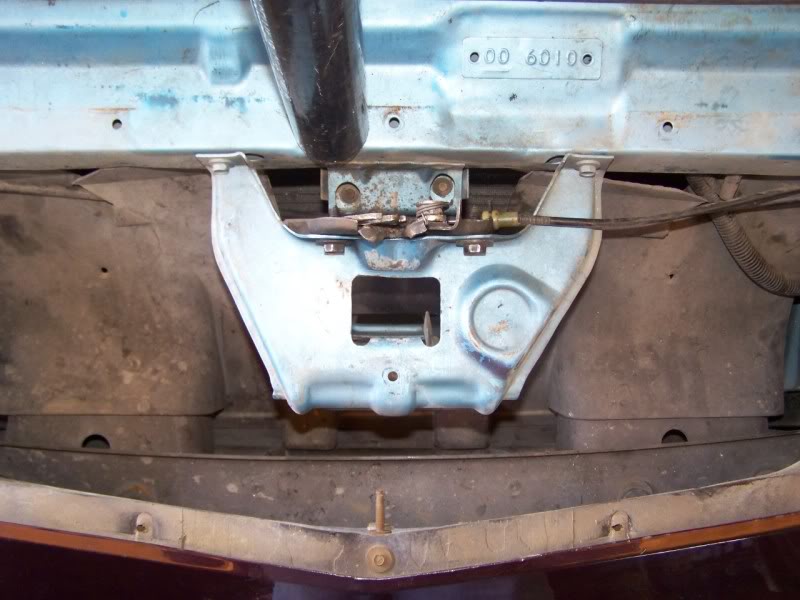

You know what I just realized?.......I'm missing a bracket.
I just went back up and looked at that diagram "84 1LE" left me (with the yellow boxes and the arrow) and to my surprise the bracket that's "below the arrow" is missing. If you look at the very bottom of the "yellow arrow" you can see two bolts that attach a thin bracket which runs up to the area where the arrow is pointing to.
On my car that bracket is missing. Maybe that's why my bumper is sagging! It appears as though the two bolts the arrow is pointing at, may be connected to that bracket that's missing on my car. I'll have to go check that out.

Yes get that bracket and when you get it you will see that there is a lot of room for adjustment. I would attach it loosely then have someone pull it up to where it needs to be while you tighten it. There is also adjustments in the brakets just next to the headlights. My car been in a fender bender and the brackets were actually bent. I had to take them off and straighten them. There are 3 total. The one you are missing and the 2 just next to the headlights(the headlight bar.
