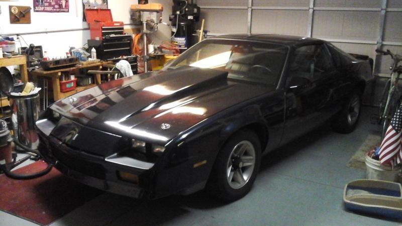

Can you post a picture or part number of the Harwood hood you have?

kinda a crappy pic for now

it was used and the label is gone. painted the underside when I fixed a few issues with it.

Looks really similar to mine, I have the Turbo hood by harwood. I just can't see mine being strong enough to hold but if you say yours holds....
