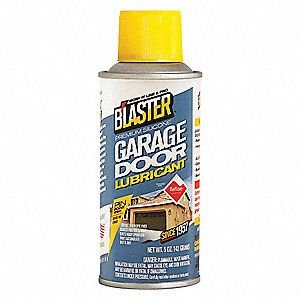

I used this, no white messy residue left behind.
