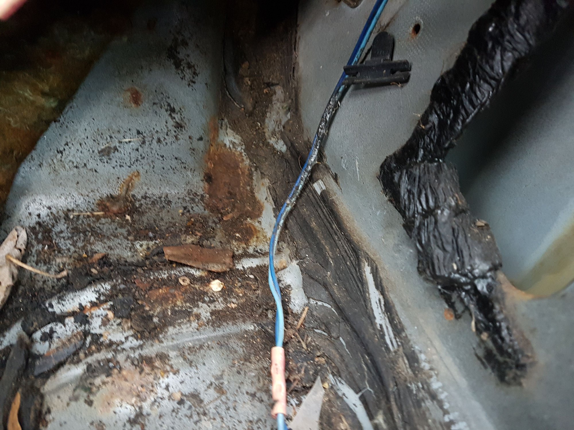

Rear section of the drivers floor. Pretty clean. Should clean up easy.

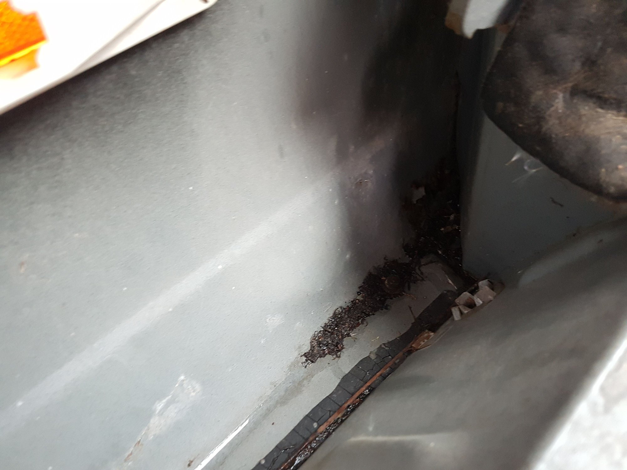

Drivers side bottom of A-pillar, essentially rust free.

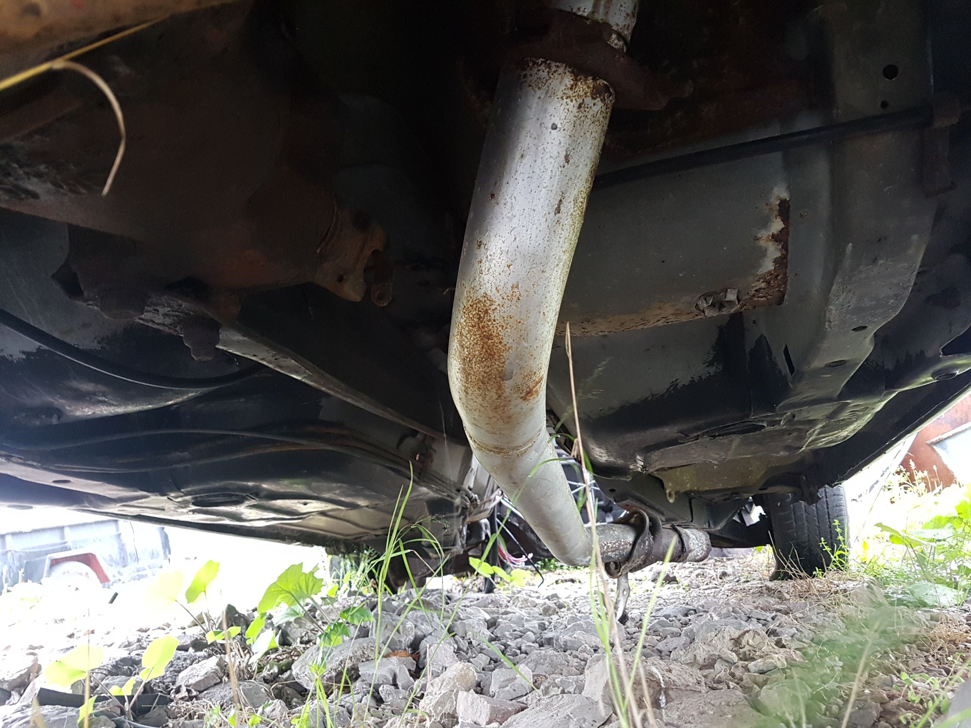

Only shot I took of the floor, as it was raining pretty good. That spot in the passenger rear seat pan is an easy fix. everything looks good, even the forward torque boxes haven't been jacked up improperly.
Bottom of passenger A-pillar. Also solid. That rust is just the door, which I have a replacement for on my car already.

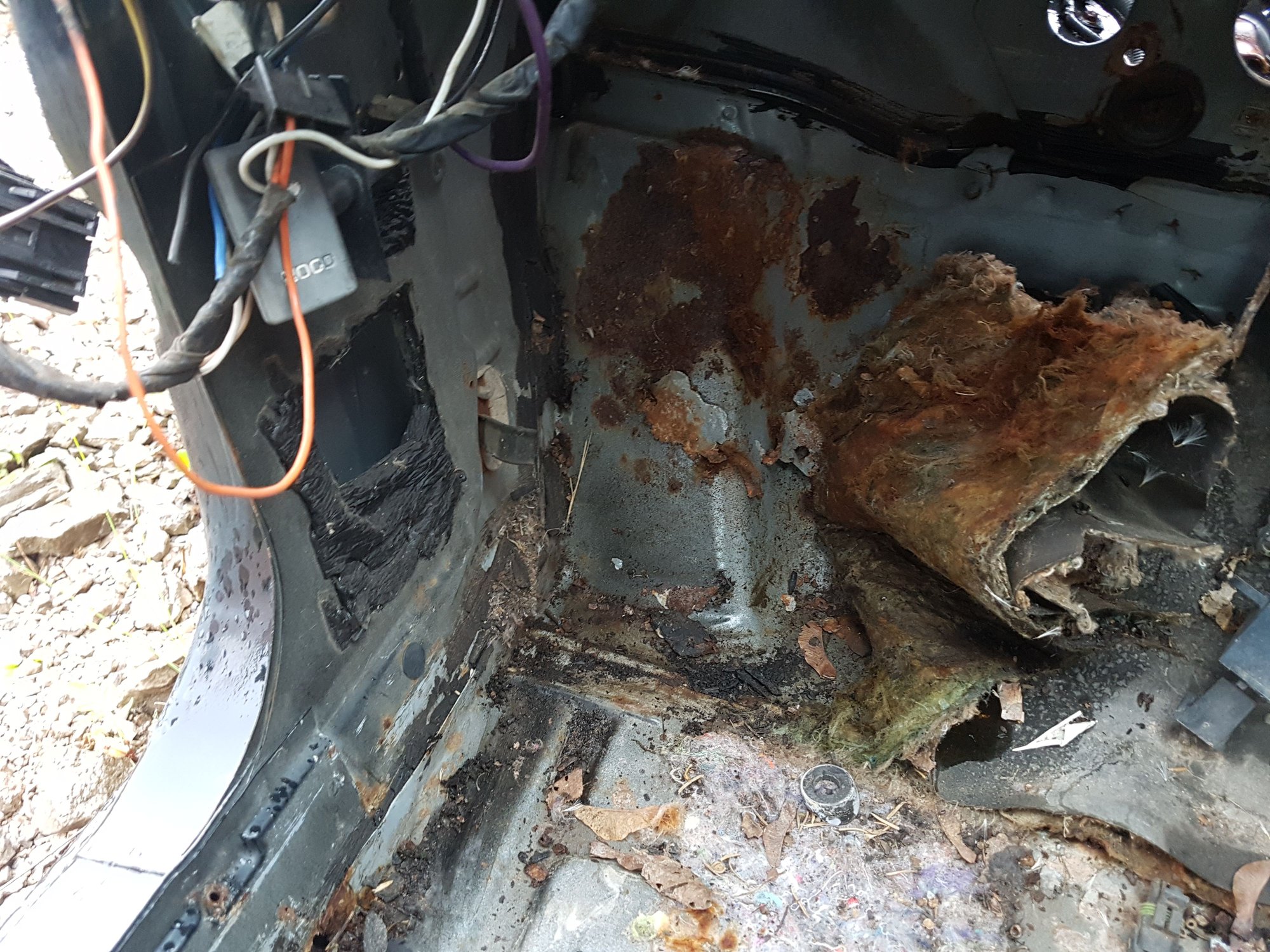

Passenger kick panel area, this is the worst of it. Another spot that should just be clean, protect and paint.
Rear of the passenger floor. Needs to be cut out and replaced... Of which I have a perfect reproduction pan already in my T/A to use (provided it isn't too destroyed after my drive shaft incident.)
Spare tire area. Perfect. This area on my car is essentially in need of full replacement, from the bottom up about 6" in to the wheel well, and the brace further up behind the quarter is also rusting on my car. On this car it is perfect.

I don't see any cutting and welding required to fix anything in those pics. Sure; it needs some real effort to clean it up, but all those pics seem to show is minor surface rust. The GTA I'm workin' on right now is in worse shape; got a hole in the spare tire well and another in the cowl. ( That cowl hole is gonna be a PITA ! )
I'm in the northeast USA and the pics show that this body is in better than average condition of any 20 year old car from around here. Just about every 'new-to-the-junkyard' Thirdgen I've seen in the last 5 years has been "Swiss cheese". I was 'saving' worse Thirdgens than this 15 years ago; so I'd be just fine with beginning a build with that body. ( This is not my GTA; it's an 86 I built back in 07' ! )
