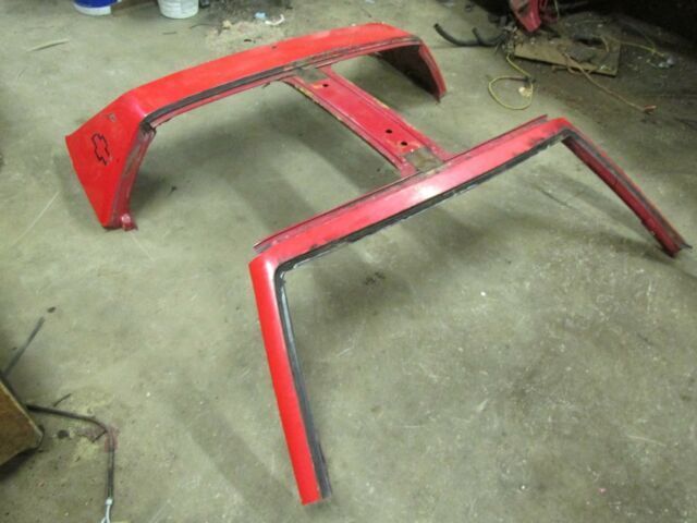

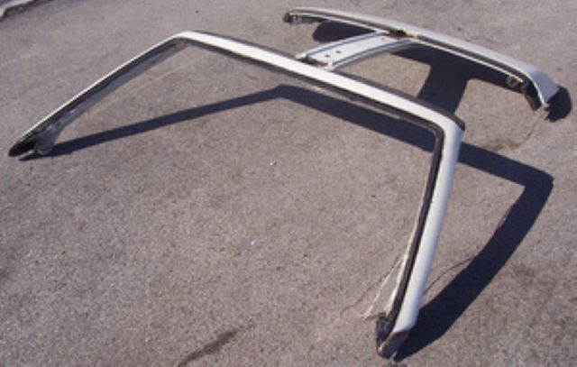

Yeah, it would require the entire roof, A-pillars and B-pillars, too, not just the top of the roof, and not just cutting into the top of the roof. So removal of the windshield and hatch, of course. Like one of these two examples:
I'm pretty sure people have replaced rusted-out t-top roofs with good t-top roofs, or to rebuild crashed cars, rather than scrap them, so this would be no different than that. I remember pictures and write-ups, I think here on TGO. Not common, so I don't know how difficult it would be to find in a search. But as long as professional body people do the work, not hacks, then there should be no reason this can't be done.
But before any cutting is done, the installation of subframe connectors would be imperative, I'd think.
As for C&C or factory, good luck finding a C&C roof to chop, unless you've already tracked one down. I think a factory t-top roof would be the better one to work with. The glass panels would also be much easier to come-by, too. And don't forget to get the little door support pieces from that donor car.
It would take a lot of time and cost a lot of money, so it would only be worth it to YOU, if you really think it is.
