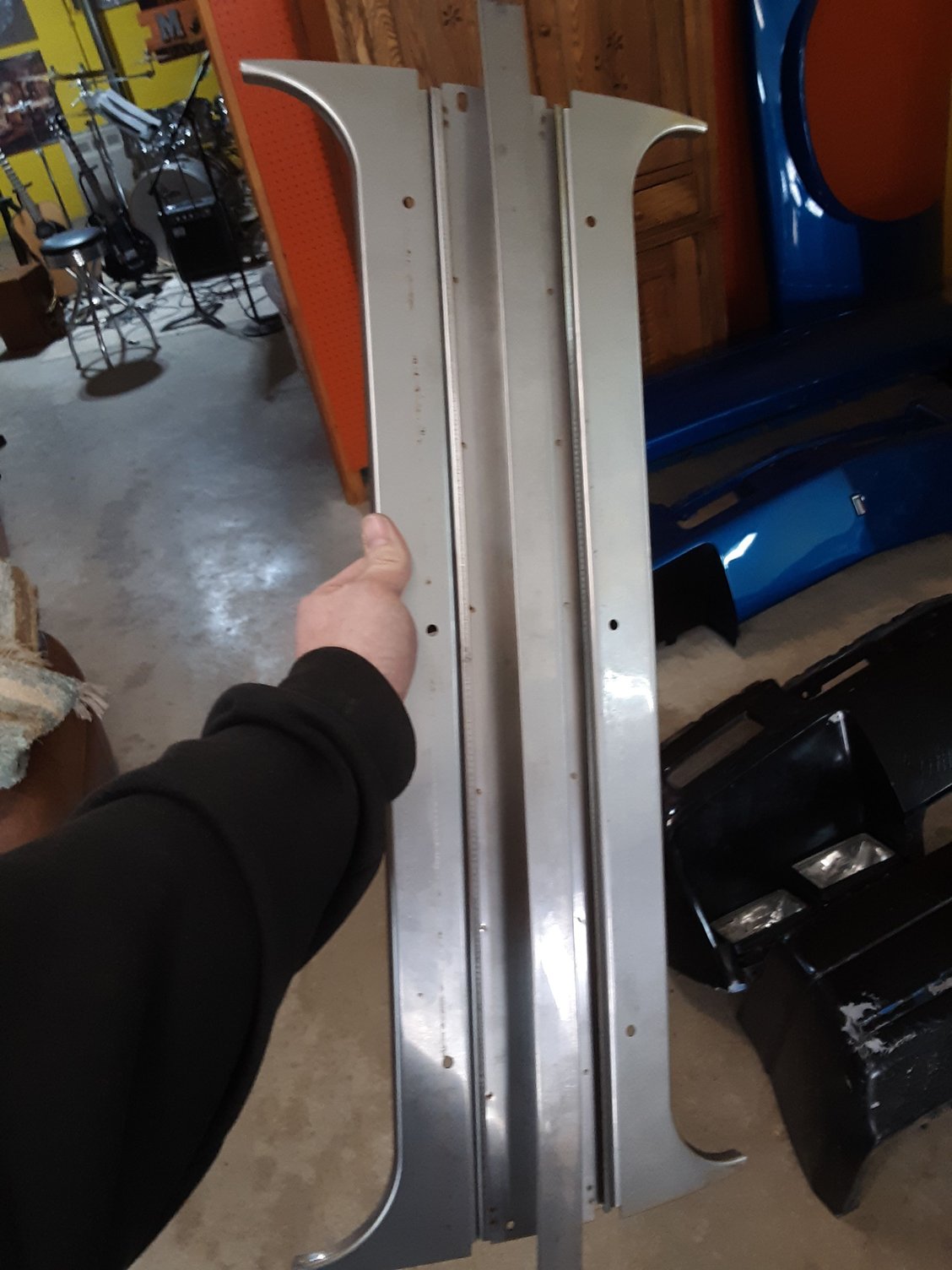

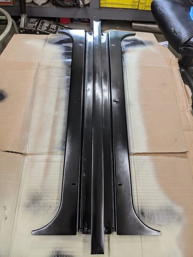

Holy crap, it came today! Talk about fast shipping! It looks like great quality. It's not painted like the picture shows, but it appears to be a nice product. Hopefully it fits!

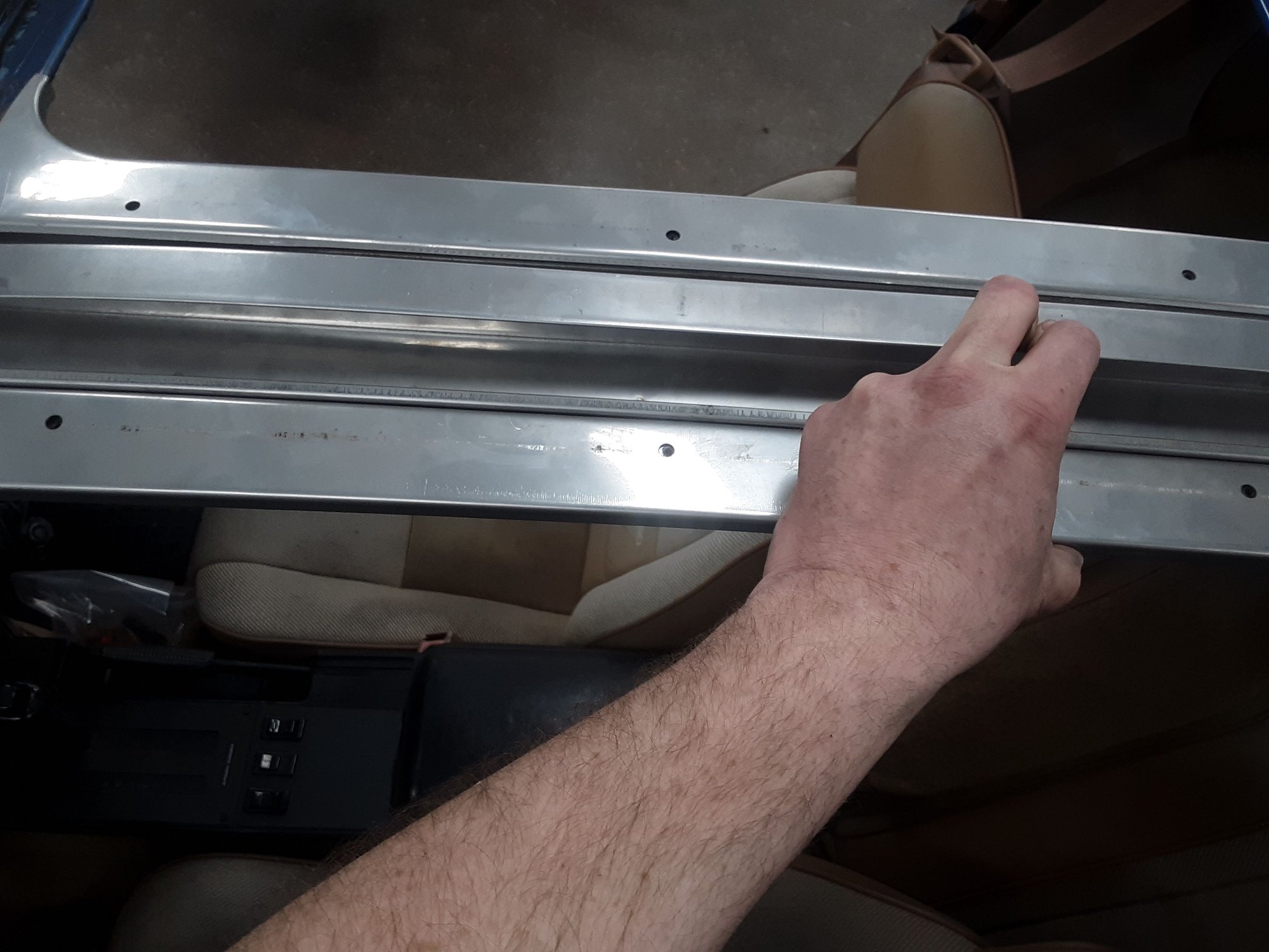

I set mine in place in my car just now. I had to tap the rear edge of the top of the bar in just a little, and had to bend the front edge of the top bar out just a touch. It fits in there perfectly, and all of the screw holes line up, too. It only fits one way, so if the holes don't line up just spin it around. GREAT product for the money!!

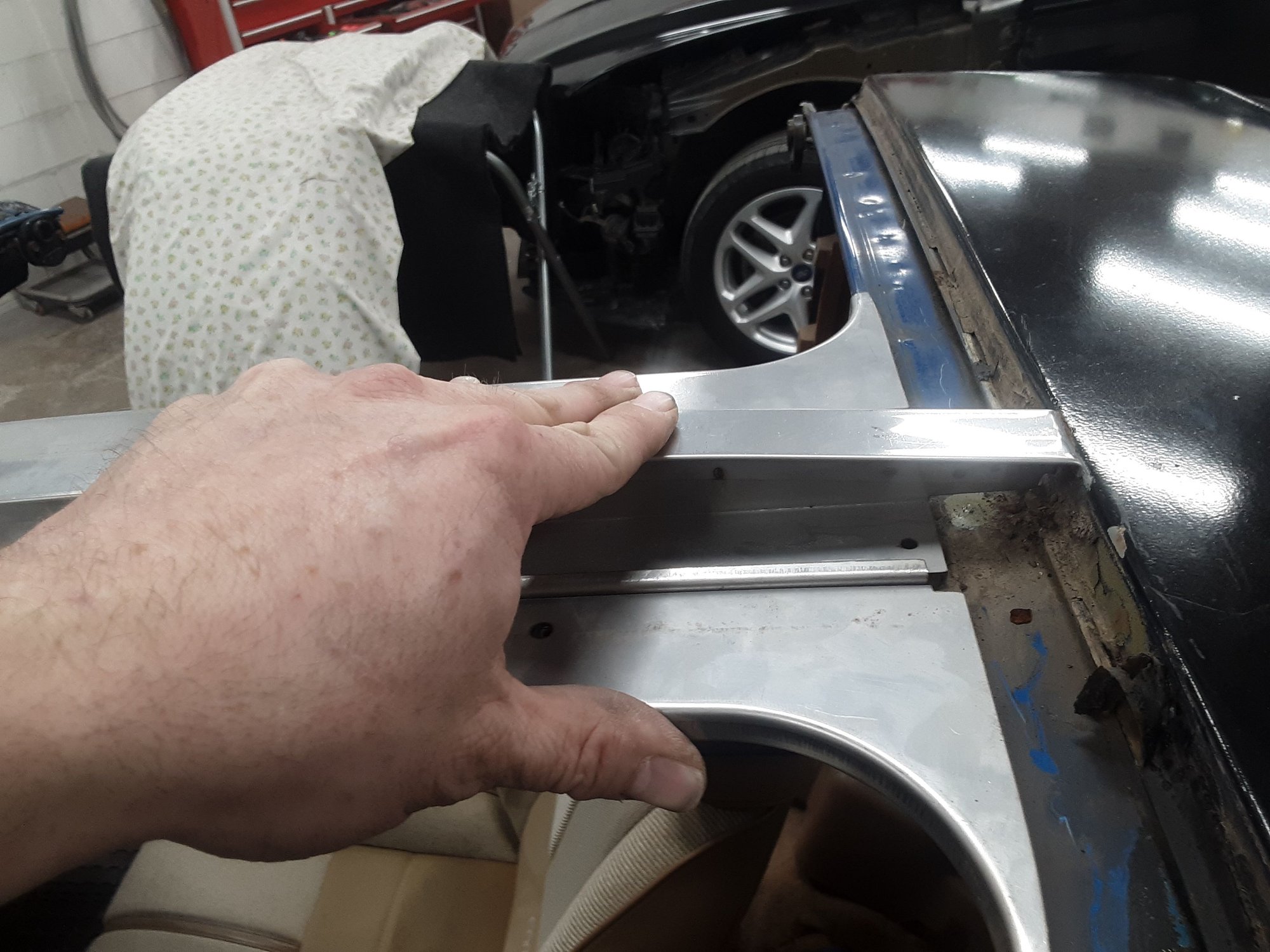

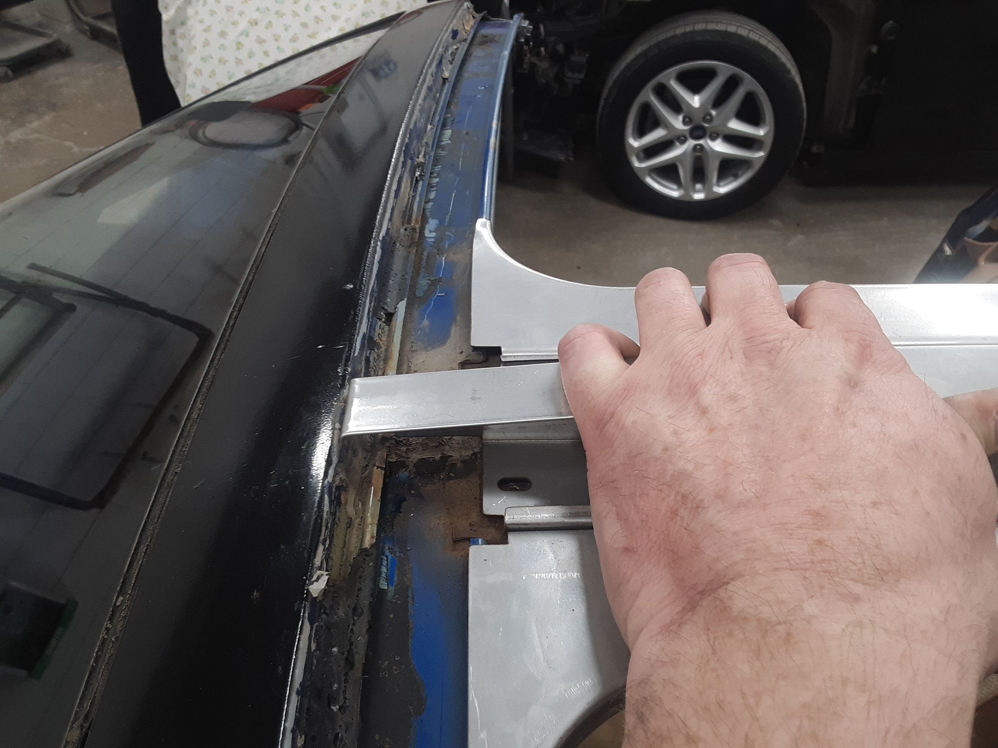

Ok. After getting the t-top bar installed, I have a MAJOR bitch with it. The side profile of it does not flow with the top curvature of the t-tops. It looks great until about 3/4 of the way back, then it gets a gap between it, and the top of the t-top before it curves back down to the rear end of the bar. I'm going to contact them and raise some hell. Other than that, everything with it is great.
Old Apr 4, 2021 | 06:59 PM
NoEmissions84TA's Avatar
Joined: Feb 2017
Posts: 4,185
Likes: 576
From: Meriden, CT 06451
Re: TTOP TBAR Aftermarket Replacement
Oh damn, another much needed aftermarket part that doesn't fit correctly.
Please post some pics.
Old Apr 4, 2021 | 07:40 PM
dagwood's Avatar
Top Answer: 1
Posts: 2,678
Likes: 1,267
From: In the paint booth!
Car: 1986 Camaro Drag Car
Engine: 383 on Ethanol
Transmission: Automatic
Here ya go. If it wasn't for this, it would be spot on.
Old Apr 4, 2021 | 08:21 PM
Joined: Feb 2017
Posts: 4,185
Likes: 576
Optical illusion ???, but it looks like the bar is correct and your t-top is warped.
Can that bar only be installed one way? In other words, did you install it backwards?
I know you are smarter than that, but $hit happens sometimes.
Old Apr 4, 2021 | 08:41 PM
dagwood's Avatar
Top Answer: 1
Posts: 2,678
Likes: 1,267
Warped t-top lol
It can only be installed one way. None of the mounting holes line up if you flip it around. I'm pretty bummed. At least it's not a horrible job to replace it. Guess I Could always ONLY drive it with the t-tops out

Has anyone else who has ordered one had a chance to check the ttop fit? I'm still on the fence about ordering one. Canadian supplier claims stock.

I finally got my car out of storage and had a look at the condition of my bar. It is trashed. I have a call in to the Canadian retailer of the ttop bar. Hopefully they have stock. I will find out tomorrow.

The TTop bar is no longer available according to 2 different suppliers. I luckily found a very good condition bar at the junkyard. I sandblasted it and will paint it soon.

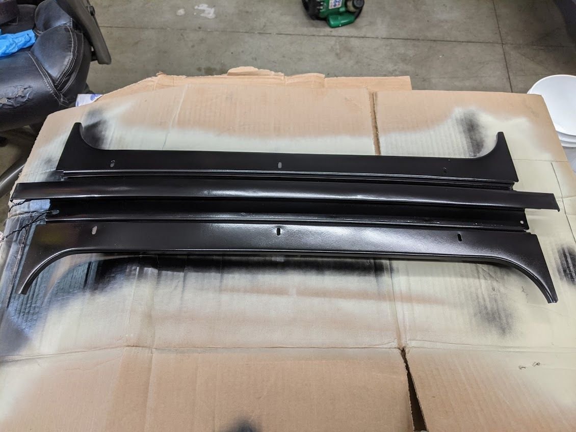

I finally painted up my junkyard bar I sandblasted.
The paint looks textured in the photos but in real life its pretty smooth. The bar isn't perfect, but its pretty good.
