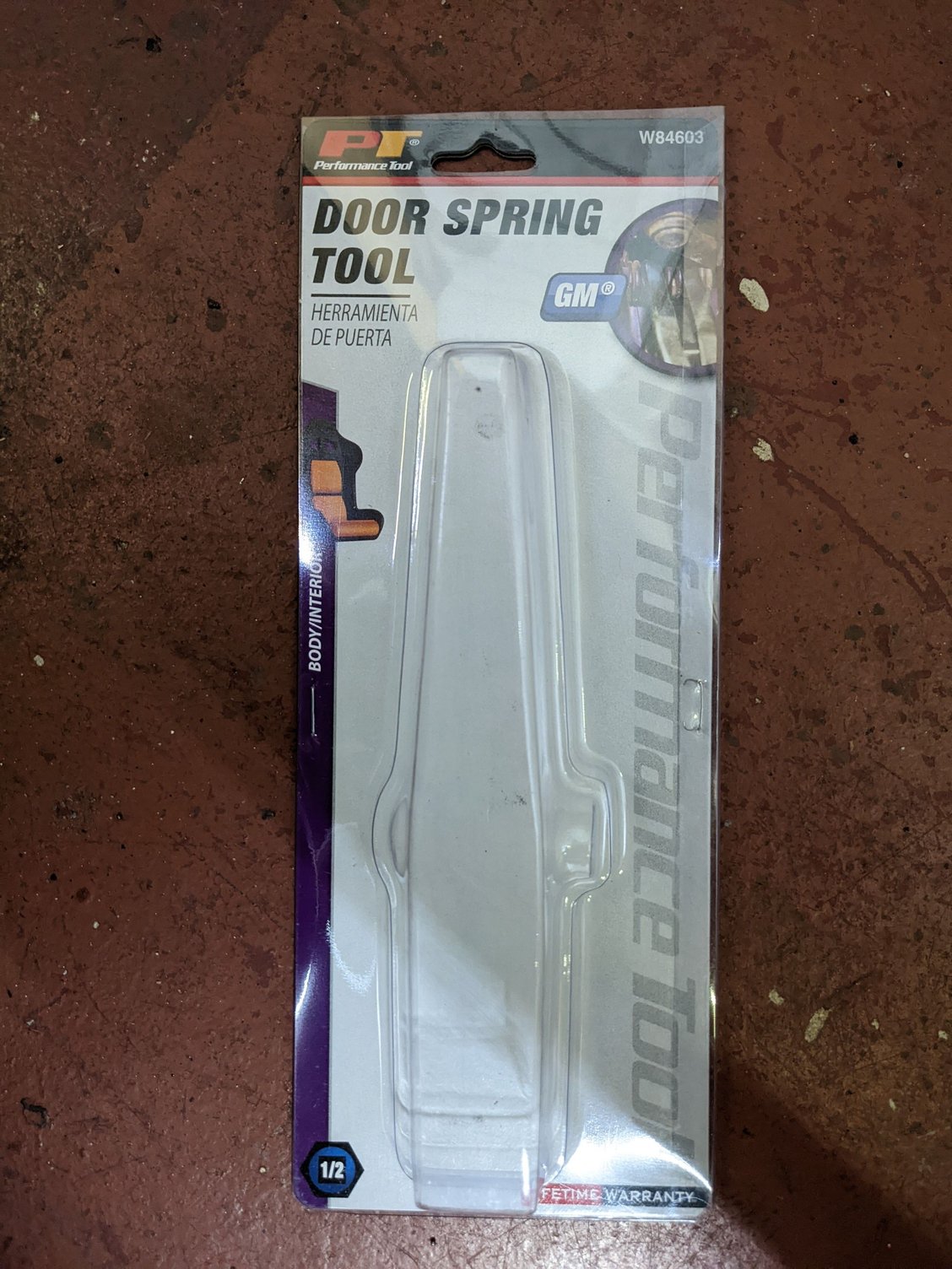

So I removed the bottom hinge first. Remove the spring with a spring compression tool. I got it a Advanced auto parts $10.
