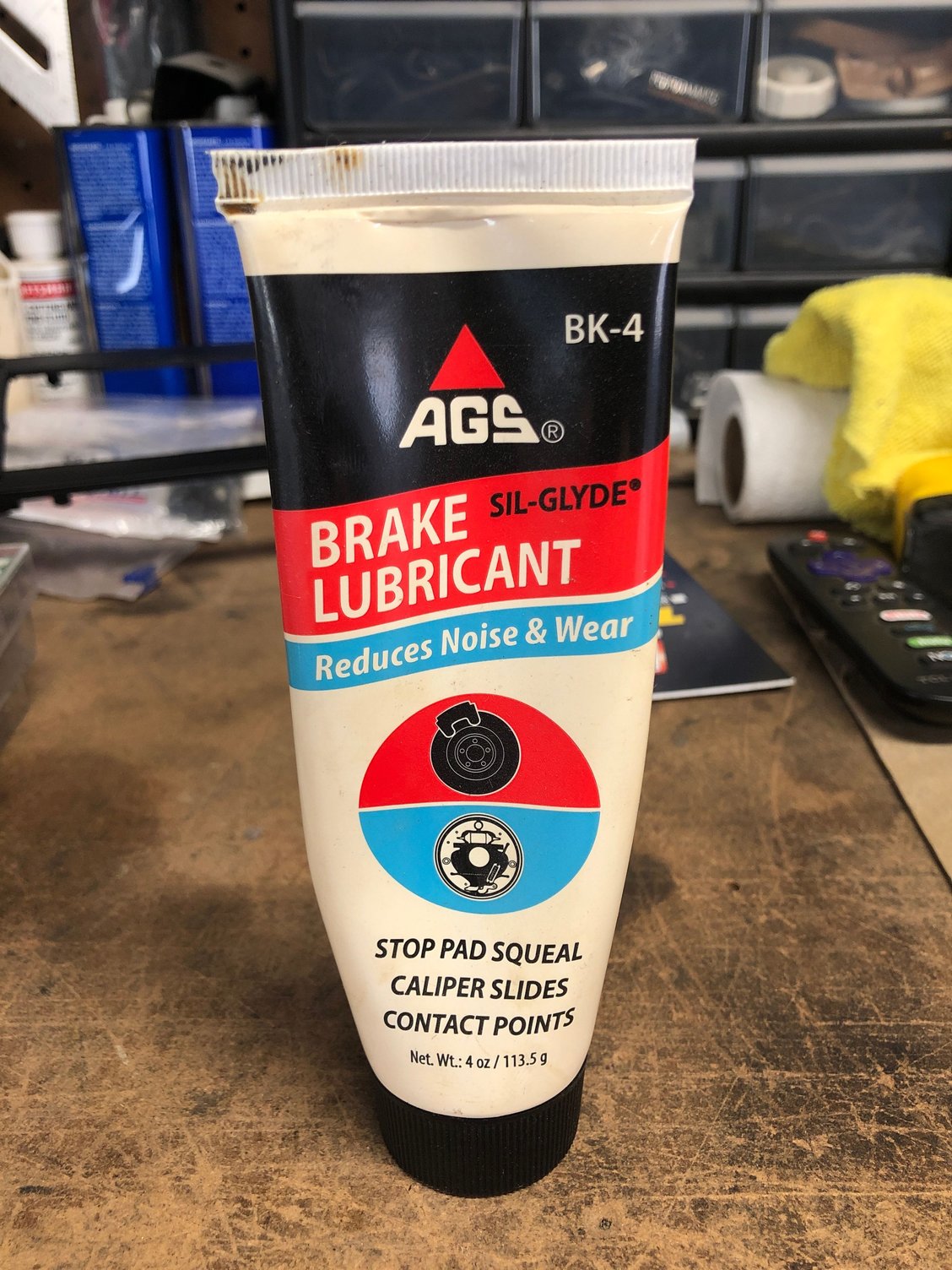

I used white lithium grease for the window motor & gears and this brake lubricant in the window tracks:

I've used to use White Lithium a lot, but it kind of fell out of favor for me. For a couple restorations I used regular all purpose grease on the window tracks and that worked better IMO. For the last few years I've begun to use Brake Lube for a LOT of stuff and I'd bet that it would work great for the window tracks !

What about Moly lube?
I bought some many years ago for who knows what, and a tiny dab of it seems to stay slick forever.
I am interested in what the factory uses for stuff like this since the rollers are some kind of plastic I would think there may be material compatibility considerations to take into account.
Yep, the Syl-Glyde brake lube has become my "multi-purpose" lube over the last 10 years or so.
