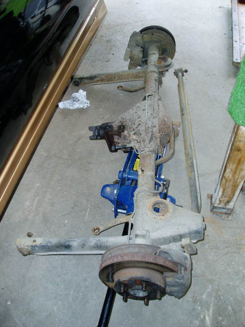

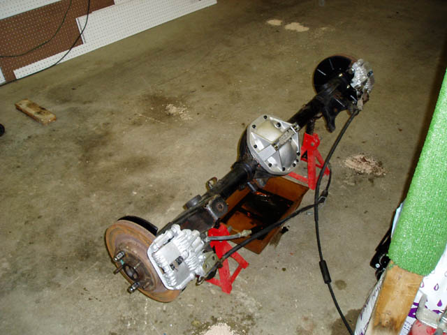

Yep, discs were a stock option in '89, and I believe that was the first year for the PBR aluminum calipers. Depending on what all was done (or not done) when they converted from drums to discs, you may just end up needing e-brake cables, it's hard to say for sure! Do you know whether your rear calipers are aluminum or cast iron? If they're aluminum both calipers will sit on the same side of the rotor (toward the rear). If, however, they are the earlier iron calipers the driver's side caliper will sit on the rear of the rotor and the passenger side caliper will sit on the front of the rotor. I don't know how much that helped, but take a look under the car and see if you can tell what is there and what isn't there. That'll be a start at least!
-Paul
For reference, here's a picture of a rear end with aluminum calipers:
and here's one with cast iron calipers:
