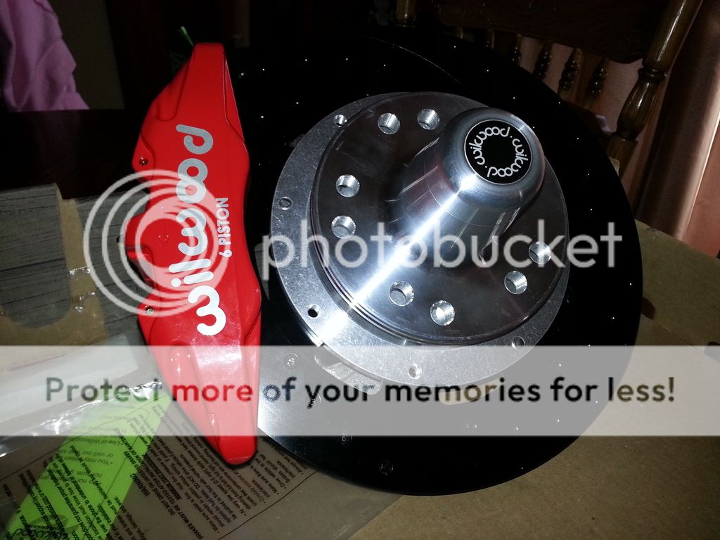

this is the upgrade 6 piston caliper and rotor (vented for street driving)
and for drag racing..this set up with my aluminum coil over struts dropped 54lbs of the front end of the car.. wildwood sold me the 6 piston upgrade brake set up for $780.
it was a new kit they came out with last year..
you can order them drilled or not...that's up to you...go see any $180.000+ sports car. and see what they run...but what do they know.....all that stuff is just for looks anyway..
the other pic with the wildwood and weld aluma start 2.0 above.. is my car. bolt on set up..
back wheel of my car..setting it up..
even if you cant see most of the chrome...I know its there..
parts are for looks only...a selling point..if you will...?
don't think they did this for just looks in the last 3 years...but I could be wrong....don't know why they keep doing it..even on the carbon fiber stuff
but then maybe it only works for Italian cars..
