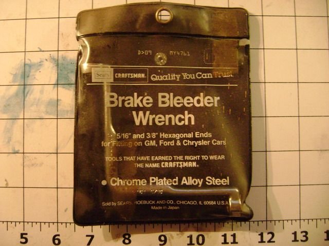

Get a brake bleeder wrench that has two box ends and a 90 degree bend in the middle. It's a deep offset that will do what you want.
In case the OP doesn't know what that looks like, you want one something like this old boy here...

But that tool wont fit. You cab just barely fit a deep 1/4 drove socket into the hole
