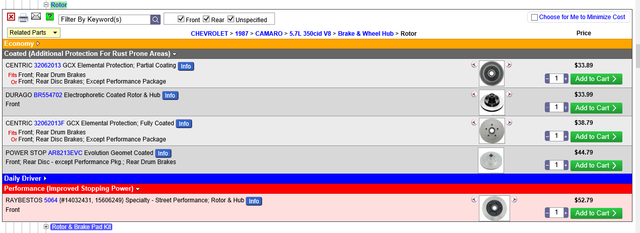

If they are for your car, then YES, stock bearings and studs. Bolt-on replacement, just drilled & slotted and coated.
What year is your car? I put in 87 Camaro. Cheaper from Rock Auto.

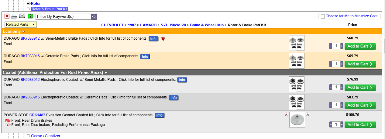

RA also has the Durago kit with coated rotors and ceramic pads (not drilled & slotted). $83.79
I have this kit set aside for my Toyota Camry. The quality looks really decent.
Go here to save an additional 5% off: https://www.retailmenot.com/view/rockauto.com

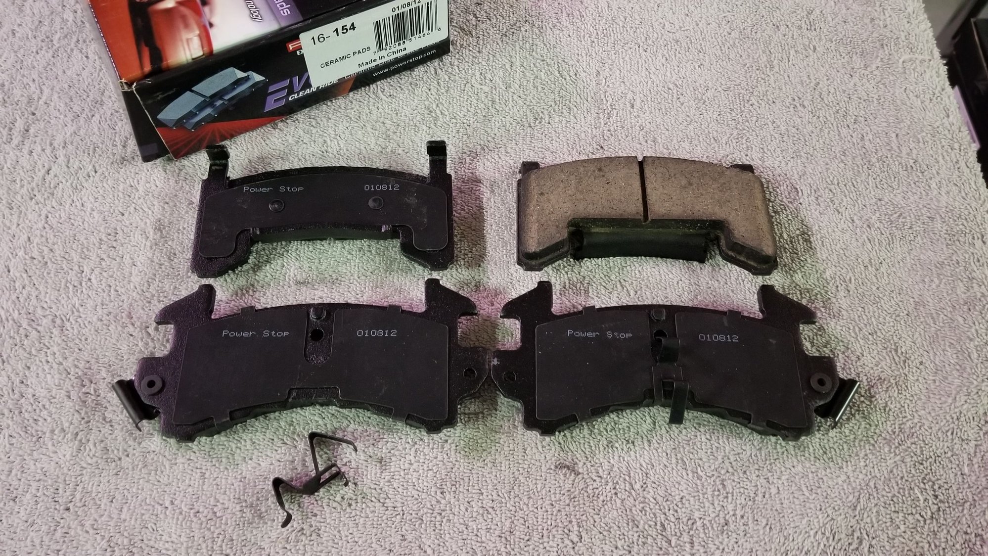

Which brake pads did you go with? I see on Summits site they say Powerstop pads won't work with cars having a J65 RPO (performance brake) code?!? I called Summit and Powerstop but neither could give me an answer.
Rear disc brakes on an 85 TA are J65, but not "Performance Package," so pads for yours are likely to be listed as "Except Performance Package." "Performance Package" came a few years later, and here on TGO it's often referred to as, dare I say it for fear that it could cause some wet panties, or worse, "1LE" brakes. That's not to say your rear brakes haven't been upgraded, but if your rear calipers match the front calipers, then yours have not been upgraded and use 154 front and 202 rear pads.
HOWEVER, for all intents and purposes, 154 and 202 are the SAME: same size, same shape, same fit. BUT there's a clip on the inner 154s that must be detached to use 154s on the rear, and there are some pretty holes in the friction material of the 202s, which matter not. Some manufacturers don't have holes in their 202 pads. And some manufacturers don't even offer 202s, offering only 154s for front and rear, Power Stop being one of those. So if you want factory-style 202 pads, then go with an OE replacement, such as AC Delco, Raybestos, Wagner, Bosch.
Sounds like Davey has Power Stop Z23-154 Carbon Ceramic "low dust" pads, which is its midgrade pad--154 being for our brakes. PS' top-of-the-line pad for us is Z26-154 Carbon Fiber Ceramic, also "low dust." And pictured below is PS' base/lowest dust pad, Z16-154 Ceramic, shown with the clip detached for use on the rear:
Not sure how Davey likes his Z23 pads, but I've used them on my truck, and I was not impressed: dustier than my stock pads, and didn't hold up well, structurally. I never installed the Z16 pads, pictured above. Z17 is the same Z16 pad, but in a "kit" with the appropriate replacement hardware.
