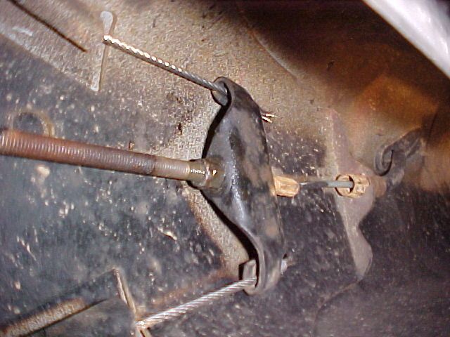

There is a cable adjuster bracket up under the car in the tunnel above the driveshaft. Basically you turn the nut on the threaded rod clockwise to take the slack out of the cables.

It is adjusted in the tunnel. The lever has full pressure at just over half way up right where it should and it doesn't hold the car at all.
