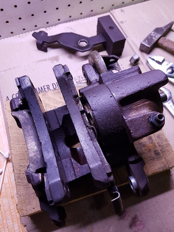

Hello,
Me also, since 2 days I repair the caliper with new kit of gasket and now I hesitate to keep the old pads(not reallly used but since 1987)
I buyed this ref (ACDelco Gold 17D202M) and two caliper NUGEON9717246B (carefully)( yesterday on RA.
on my GTA 87, I believe what I had the original brakes pads, it is "stock" to stick them ? And I don't understand how to put the shoe dampening spring ....

Re: Replacing rear brake pads on an 87 GTA
Your picture shows the correct installation which is confirmed by this picture from the Haynes manual.
Thank you for the spring pictures and description. Much appreciated.
