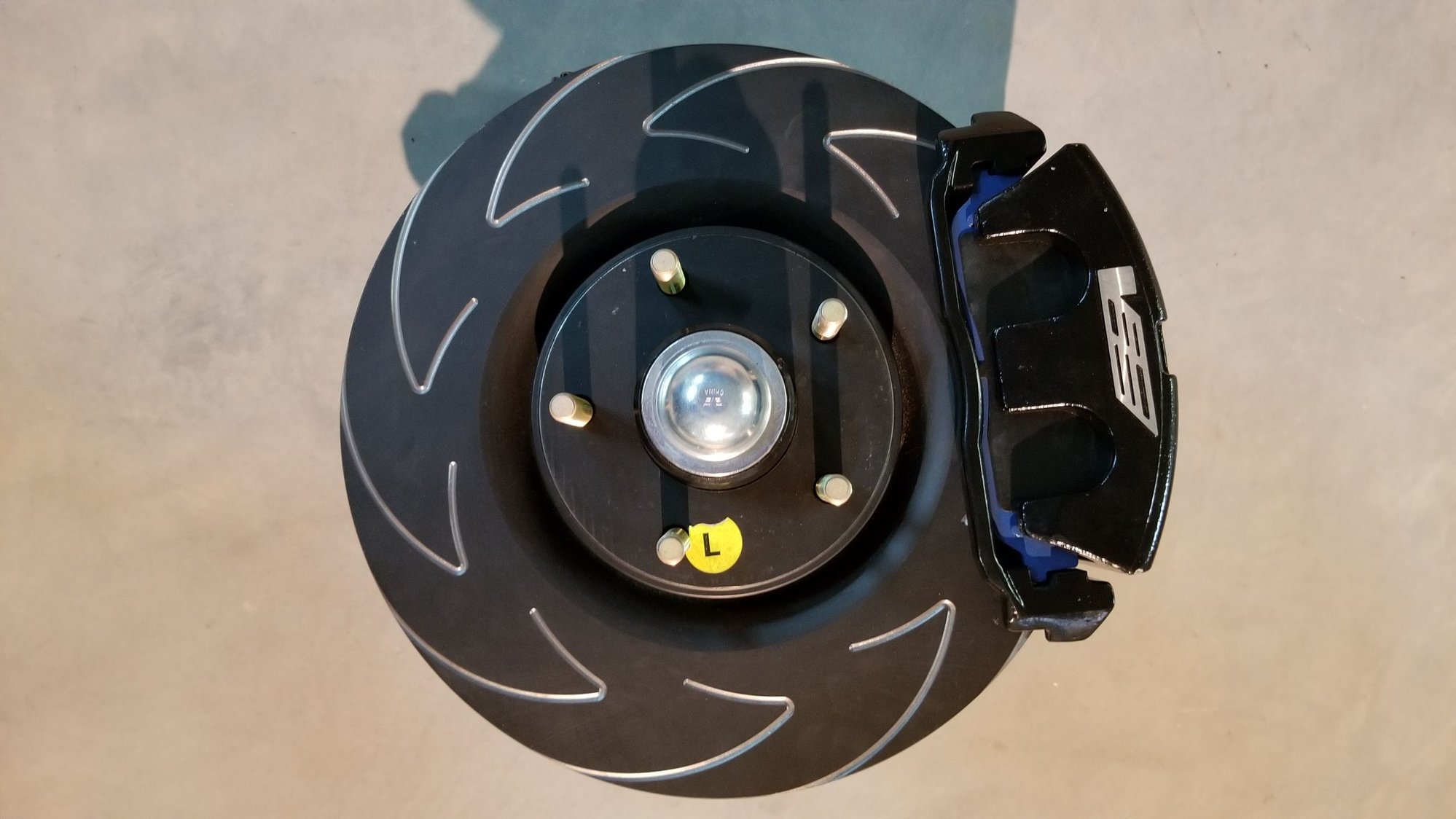

Jul 1, 2022 | 02:51 PM
Re: Cadillac XLR & XLR-V front calipers same as C6 std Calipars?
The C7 (ATS) Brembros are all in, and honestly... they're pretty amazing!!!
Full story can be read here:
ATS (C7 Base) brakes on a 91 Z28 - My Experience - Third Generation F-Body Message Boards
