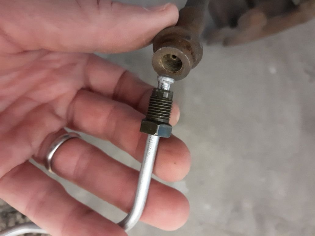

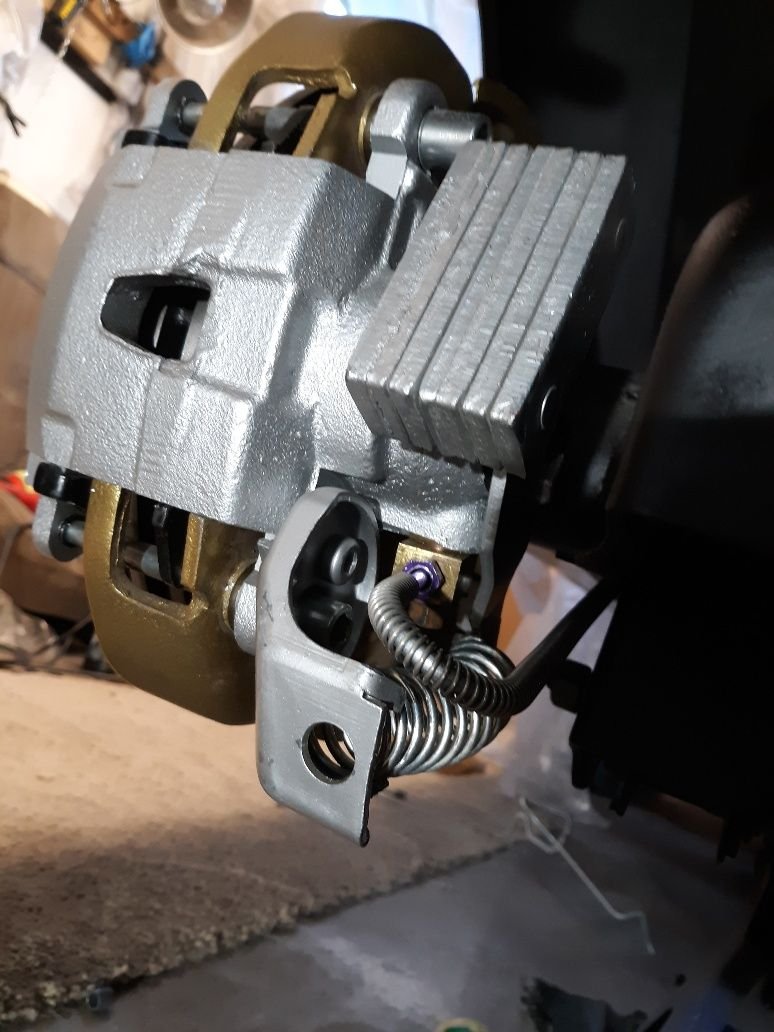

83 rear disc brake

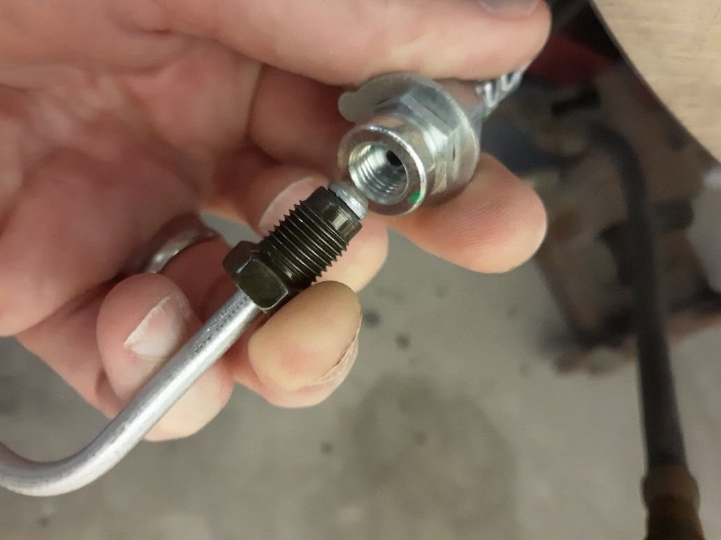

83 Raybestos hose on left compared to original
83 hard line from Inline Tube will not go into original rear caliper hose.
83 hard line from Inline Tube will not go into 83 Raybestos hose.

That hard line is a metric bubble flare. It's not 83, it's 84-up. The original hose has a SAE 45° inverted flare, correct for 83. No surprise they won't mate up.
The new hose in the 1st pic looks right but it's hard to tell from a photo. The angles of things down in there don't come across with a camera very well.

Yeah, the bubble flare will not allow it to grab the threads on the factory hose or the new one. So, I will reach out to Inline Tube. This is the second set of rear lines they have sent me that don't fit.
