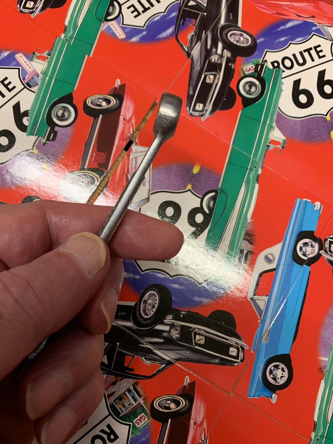

Now it's been a couple of years but if I remember correctly I placed a box end wrench on the bleeder and with the wrench in place push a clear plastic hose onto the nipple. Loosen the bleeder with the wrench, have the wifey pump the brakes and the old fluid goes out the clear plastic tube and into a plastic pop bottle. When the wifey gets to the bottom of the peddle travel she holds it there, and I tighten the bleeder without removing the clear plastic hose. Repeat until no bubbles are seen leaving the brake cylinder.
You might need a wrench with an offset to get far enough onto the bleeder. If the wrench only slightly grabs, loosen the bleeder with a socket first and once loosened place the box end wrench on.
The rear drum brake cylinders are recessed into the backing plate. A standard wrench (and the offset wrenches
like this) like this)
will not fit into the small area the bleeder is recessed into because the box part is too thick. Official GM service information recommends using a special tool that looks like a socket with a bleeder nipple on the rear end that you can attach a hose to. I've looked for one of those without luck. With standard tools the only way to get on the bleeder nipple is is to use a 5/16 inch deep socket and take a bit of a bath.
This is exactly how I did it...wrench, clear hose, pop bottle. Wheel off, worked by reaching over the top. Kept a catch pan under it. Hosed the backing plate off with brake clean when done, drip dry.
Interesting that the OP's '91 has a different design (the '88 is bad enough with it's "clip" to hold the wheel cylinder in place). I didn't keep my '91 long enough to find out. Brakes and clutch were still good. The rear 16" Eagle GA tires on the other hand were showing their wear.

Originally Posted by Dartht33bagger
The rear drum brake cylinders are recessed into the backing plate. A standard wrench (and the offset wrenches like this) will not fit into the small area the bleeder is recessed into because the box part is too thick. Official GM service information recommends using a special tool that looks like a socket with a bleeder nipple on the rear end that you can attach a hose to. I've looked for one of those without luck. With standard tools the only way to get on the bleeder nipple is is to use a 5/16 inch deep socket and take a bit of a bath.
Aye!
If I were handy with a welder I would fabricate one of those myself.
As things are, I loosen the bleeder screw with a socket, just far enough that I can turn the socket with my fingers.
Then I remove the socket, stuff the hose on the bleeder and open it the final distance by twisting the hose.
Usually letting go of the hose also tightens the bleeder enough for the next go at the brake pedal.
