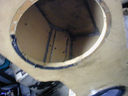

Old Apr 18, 2003 | 07:14 PM
Xceleratemaro's Avatar
Joined: Nov 2002
Posts: 864
From: greenvill sc
you will be happy that you used mdf bord becouse it sounds real good take your time and make sure that the box is sealed
mine is one ci foot
