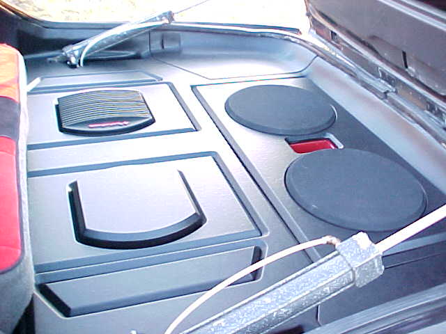

Originally posted by DigitalMonarch0
I am trying to come up with a unique way to keep the speakers (somewhat) hidden and still be able to store my t tops.
i hate to use this as an example but its the only one i have right now

That's looking like the best bet at the moment. Now I only have to find a good spot to hide the amp so that it can't be seen in the window.
