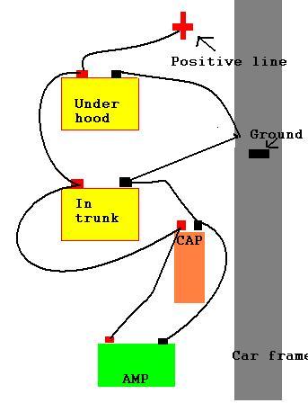

In the picture is how my batterys are hooked up. are they hooked up correctly?

That pic has nothing to do with you.
You really SHOULD be running some kind of isolation on the two batts. Solenoid isolation is cheap, i like it. You should be able to find a pic of how to wire it you on-line. I'll try and find a link.

In general this is a good explanation, but note that in method one they say what you did was OK, They're wrong......

good question...i've been wanting to add a second battery to my own car for quite some time. describing the best way to do this would help. i already have one in where the spare tire use to be however there wouldn't be room for two. would it be smarter to relocate both to the other side or one on each side?

Probably a good idea to use fuse logs too. In my dual battery system I'm using a fuse log on the strut tower, then pac isolator, ran wire into the car then another fuse log on driveshaft hump, then goes into the 2nd battery. That way both ends are fused so hopefully the line will go dead under the carpet if something happens.
As for isolators there pretty nice. You can pick up decent little solenoid ones off ebay for around 50 bucks or so. Kind of nice being able to jump start your own car after your wet battery has got partially depeated over winter.
Flip the switch and the 2nd battery kicks in and is usually enough to get the car to enough volts for the starter to work.
Also for the ground wire you can go to a sheet metal contact as long as it's a good solid connection.
I imagine from that second pic with the optimas they were wiring them in series for the extra volts for that big pump... not a good idea when most amps peg out at 16+ volts or so.
Also I'll point out dual battery systems and caps won't fix a major power problem... believe me I've been dumb enough to try that. Basically you'll need a bigger alternator to keep them charged if you're putting a big strain on your current electrical system. My setup drains both my optima and regular wet battery to 9.0 volts within a few minutes with the car and stereo running... on a pullied 105 amp alternator.
As for a battery on each side it could be done, but you would need more fuses to connect the two up. I doubt from how nice your car looks you would take the chance of running a live wire between the 2 batteries anyways
I would still use an isolator though in either case. Heck I've even seen pictures using several isolators on multiple battery systems... like the people running 3 to 5 batteries they had a solenoid type between each so they were perserved seperate when the car was off. I guess it would just come back to if you wanted one on each side or both on one side. Either way it's gonna take a custom bracket like shown in the picture. I would imagine putting both on the same side would look a little cleaner.

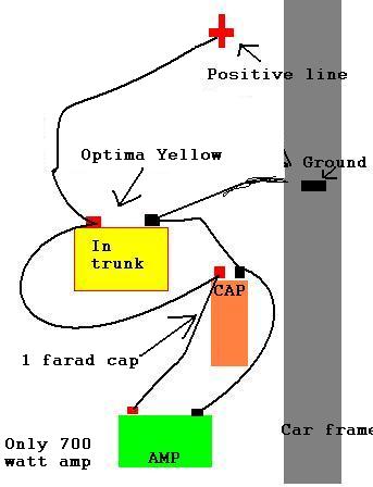

this is how i would like to have it hooked up... i want a powerful battery that runs my stereo and my amp with no problems . i even want to be able to blare my radio and subs when my car is off... optima yellow seems to be able to do that.. im also gonna keep one of my old wetcell batterys sealed up next to the optima incase i drain the optima. I want to get the battery out of the front and put it in the back..

also i already have a fuse inbetween the cap and the batterys.. so if anything did happen my stereo is safe.
You still don't have i isolator in the Pic there.
All you need for a solenoid isolation is a Ford starter solenoid, not much cheaper then that.

I would put a fuse between the battery and the carpet before you run it up to the hood too. Just for safety, you don't want to run a live wire under the carpet all the time without some sort of protection.
As for blaring the stereo with the car off it works to a point but then once you get where you're pulling a ton of power off the sitting batteries (only holding 12.5 volts at max). It won't be long before you run into power issues, cause you'll be draining them because the alternator isn't charging them back up.
But ,yes if you were wanting to put a battery inside the car an optima or really good other sealed battery would be the way to go.... just ask my friend. The local audio shop (same shop I had problems with) told him it was fine to use a wet battery... I said go sealed and he didn't take my advice. Well, turned out his battery leaked into the interior. It ate part of the sticker and some of the cosemetic coating off his JL 1000/1 and stained is carpet all up.
Ok as for needing same type batteries... yeah that's what everyone says. An isolator will automatically seperate the batteries when the car is off or the switch is flipped off. When the car is on you can connect the 2 together... Do you really think the batteries care which one has more cold cranking amps? From what my father (electrican) told me it doesn't matter as long as their at the same volts. So you're alternator is charging at times and sometimes it turns off, depending if you need more volts at the batteries or not. Well by connecting them in parallel you're just in theory making a bigger battery surface. Hehe think about a TV remote where you put 4 AA's in it in parallel/series do you really think the remote cares it's 4 seperate batteries? No, because all it needs is the set volts total from the 4 AA's, if it gets that it's happy.

As a retailer, I would love to sell you an alternator, battery isolator, more batteries, etc.
First off, if you have 700 watts, I wouldn't recommend a battery. Imagine getting a bigger gas tank, think it will get you better mileage. Similar analogy. An extra battery gives you more car-off listening time. It does nothing for you with the car on. I would recommend upgrading the wiring from your alternator to your battery and from your battery to the ground. Having a 1/0 wire go back doesn't help much if you only have a 4 guage coming from the alternator to the battery. Same goes for an extra alternator. Like putting Z-rated tires on a golf cart. Complete overkill, and you could spend that money in a number of other places.
Next thing, I wouldn't run the batteries as you describe unless they are of the same age, same brand, and same type. No different than the warnings you get on most items that run on batteries, do not mix different types or ages of batteries. Why? Your charging system is going to follow the path of least resistance, which will usually be the newer battery, battery with the shortest run from the charger, and/or the easiest to charge.
Another thing to keep in mind, batteries are under the hood for a reason. They thrive in a warm engine compartment, not an ice cold trunk. This affects charging as well (as mentioned above, path of least resistance).
Here is how I would do it:
1. Two batteries, brand new if possible, same kind, vintage, etc.
2. Both batteries under the hood.
3. A solenoid (a large relay, called an isolator) to isolate one from the other. I would rig it so when you turn the car off, you disconnect the front from the back. Do not get anything with a heatsink (a isolator/relay/solenoid is about the size of your fist for a 200 amp one (the one I recommend)). If it has a heatsink, it is turning voltage into heat, and your not getting all the voltage your rear battery needs. It something out of the RV and boating world you should never put in your car (its a relic from the old days of sound competitions when they awarded points for having two batteries and required them to be isolated) . Plus they are bigger, harder to wire up, and all around suck.
4. Hook up stereo to the disconnected battery so you don't drain the starting battery when running your system with the car off. Nothing looks dumber than cranking your system to look cool, only to look like a tool when you have to get a jump.
