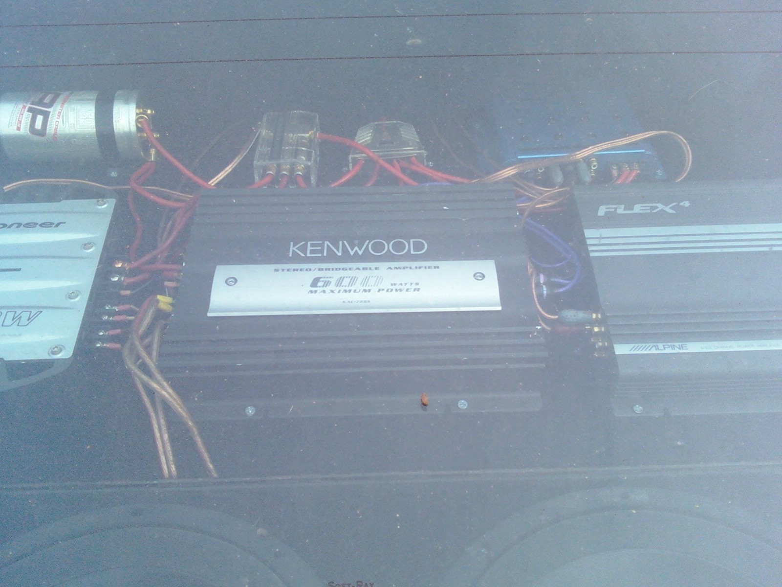

I have a 1984 Berlinetta, and the Previous Owner decided to put in a new audio system. Not exactly sure what he has done since the car still isn't home. He said he replaced all the speakers, and put in 2 Xtant A 12" subs. The subs are mounted in a factory well cover? I've never seen any of these before... Just asking if I should make a box, and what i should do with all this clutter...(I'm guessing he just got lazy).
Sorry for the novel, ^ but thanks for reading.

Looks like they knew what they were doing on hooking everything up but wasn't too worried about how the wiring looked lol. Yea I would definitely try and clean the wires up a bit by hiding them. You will prolly get a lot of **** for that because of how it looks but hey if it works and sounds good then go for it.

Id get two more kenwood amps, & take the other two out. I have an alpine and another that I dont know the name of off hand. Had the off brand one sitting around for about 5 years, so I threw it in for now (works the 6x9's). When I ever get money I will get another alpine.
Looks like it would be hard to hide all the wires you have in their. In the least put as much as you can in Some wire loom. The more runs of wire you can get in one loom the better. Or if you want to be funny you could use some small pvc painted to match ur carpet.
Might look better.

Do I even need 3 amps? He has left one hooked up to the front speakers, and the right speaker hooked up to the speakers in the towers. And the middle 600W Amp is hooked up to the 2 12" subs. Can I just get one big amp and still have the same audio quality?

It would be best to run two amps. A mono for the subs and a 4 channel for the other speakers. I would make a box that is made specifically for those subs and mount the amps elsewhere to make is look nice. Thats me though, I wouldn't run one big amp because power would be split too many times and make it sound like garbage.

Alright well thanks. I'm by no means an audio expert, just know very little from what the P.O. told me... Still waiting for it to come home. And yes, I was thinking about building a fiberglass box.

What I would do is start all over again.
FIRST. the power wire is too small, seems to be 8 gauge at best, and for mutiple amp systems a 4 gauge is needed. run a 4 gauge to the battery, through the firewall and a proper grommet and fuse within 12 inches of the battery. run to distribution block and then 8 ga. to each amp.
SECOND, PO used RED wire for the ground wires. while not technically wrong, it can get confusing, if you hook up an amp reversed, it may short it out. they are fused internally, but it may get by the fuse and kill it before the fuse has a chance to blow. Use black or silver 4 ga. to the other distribution block and Black or silver 8 ga. to each amp for ground.
THIRD, The pioneer amp is good for the subs and the Alpine is a 4 channel which will run the rest of the system. get rid of the other one, unless it was a band-aid for two bad channels on the alpine (I've seen that done). get rid of the capacitor, shouldn't need it unless the car's charging system is weak, again another band-aid, or the PO thought it was cool. in any case, I've only HAD to install capacitors in systems that ran upwards of 10,000 watts, and the owners didn't want to upgrade the alternator. It looks like they used an electronic crossover setup, which I would keep, gives better (correct) sound frequencies to each amp. Hide/reroute as much wiring as possible, proper display of wiring can actually add visual appeal to a system, be creative.
Lastly, make sure that the amps are NOT screwed down to the metal in that portion of the car, as the gas tank lines and the tank itself are less than 1/2 inch below there, put a piece of 1/2 inch MDF wood under the carpet or carpet a piece to match and screw the amps to that. seems you have some fun ahead of you!!! ps I've been installing professionally for over 10 yrs, and would be happy to help guide you through it if you want.

I'm not sure on the gauges but there is about an inch thick wire running from the battery to the first wire splitter thingy. And thanks for all the help... I have alot to tackle yet. When i Get it home, I'll keep you posted.

I am a fan of Pioneer, Rockford Fosgate, and Crossfire. I have one of the 760w Pioneer amps from Wal*Mart (remember, I used to work professionally installing car audio components at a shop), and this Pioneer amp puts out every bit of 760w, even though it is rated at 4ohm, I run it on a 2-ohm bridged load with two Crossfire CF310D's (dual 8ohm coils running at 4 parallel into 2 bridged). This amp, will not only drive them (250w @ 4ohm, 500 @ 2ohm ea.) but it makes them hit harder than most 12's and 15's I hear around here. I have had them for over a year and a half, and they haven't had a single problem or hiccup.
Now, if you want to get into it, I like Crossfire products the most for price, quality, and loudness. They make a good product, while hard to find a distributor, they label the products accordingly to what they ACTUALLY put out, not numbers that look appealing on a box. I have installed and tested MANY combination's of Crossfire systems and by FAR like the amps they produce the BEST. The amps have the most clear sound, put out more wattage than rated at, and last forever from what I've seen so far.
As for Rockford Fosgate, hands down, sound quality, and nothing but. Loudness, sound quality, cheap price, once again, products that put out whats listed on the box. Had two Punch 12's at one point, wish I had never gotton rid of them.
Now I also tried a 1200w Sony Xplode amp that was lying around in the shop on my two Crossfire's one day. This amp did power them, but frequently overheated and kicked into safety, and did NOT power them with no 1200 watts like it said. It also made the sound basically garbage, and the amp was brand-new nothing wrong with it. This isn't the first Sony amp/speaker combo I've seen be that terrible either.
Basically what I'm getting at, is if you want to go a bit cheaper, Pioneer is a GREAT way to invest your money, and they last forever, my 6x9's and 4x6's are AMAZING just off of my Pioneer head-units power.
Looking to go a little bit more pricey? I would choose Crossfire or Rockford Fosgate, both exceptional brands with names and support to back them up.
And lastly, if it don't sound right, check how its wired. A bad ground can make your amp lose power, or sound terrible, and a faulty, knicked, or damaged/oxidized 12v lead-in can do the same.
To that distribution block, you should run AT LEAST #0 wire, and then 4ga lead-offs, and its always better to have a larger ground than positive on the amp. You can put out as much power as you can move through the amp, power always flows from positive to negative
And justly, I would replace it with a 2ch for subs, and a 4ch for components, delete the extra, and keep the crossovers. Keep the capacitor, it was probably installed for a reason and theres no point in removing it if its already in-place. If you run more than 1,500 watts, look into another battery.

alright thank you very much, ill look more into the higher end of amps and subs... kind of off topic but is dynamatt worth doing?
also, i looked up the Rockford Fosgate 12" punch subs... they seem extremely reasonable.
Now, as for an amp to power those...? like a single 1000W with 2 channels? and a 4 channel to run the rest correct?
