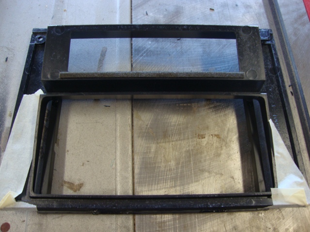

(Mudd746How did you custom your Bezel to fit Double Din. What did you use??
Old Sep 24, 2015 | 12:06 AM
  #58
mudd746's Avatar
Joined: Feb 2008
Posts: 166
From: Tucson
Car: 89 IROC Convertible
Engine: 305HO
Re: Double Din Head unit used? Who has put in a double din?

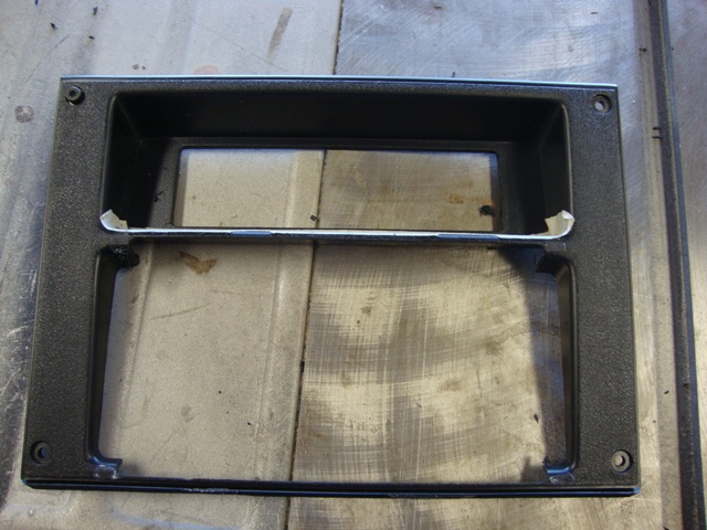

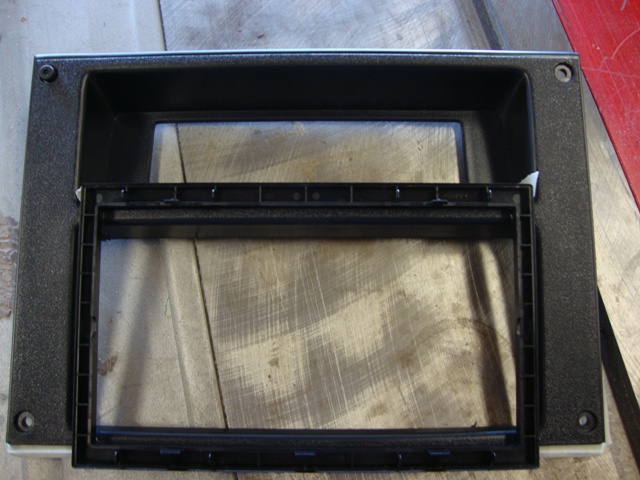

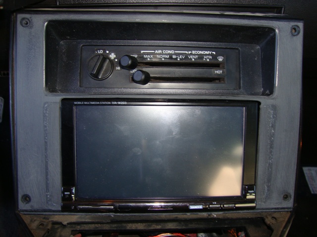

used oem bezel, routered out a larger hole then filled in sides with abs.

What did you use?? You think you guide me through process. Thanks I appreciate it.
Old Sep 24, 2015 | 12:14 AM
  #60
yankeecarman's Avatar
Joined: Sep 2002
Posts: 1,099
Likes: 21
From: Melbourne Australia but from South Carolina
Car: 1991 Trans Am convertible
You can buy an installation kit and that contains the abs shroud that goes around the radio. Also, it give you the brackets for mounting.
Old Sep 24, 2015 | 12:17 AM
  #61
echavez95's Avatar
Joined: Sep 2015
Posts: 4
Thanks I will look into that.
Old Sep 24, 2015 | 12:35 AM
  #62
mudd746's Avatar
Joined: Feb 2008
Posts: 166
From: Tucson
Engine: 305HO

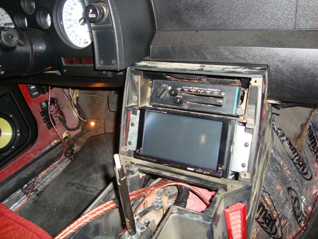

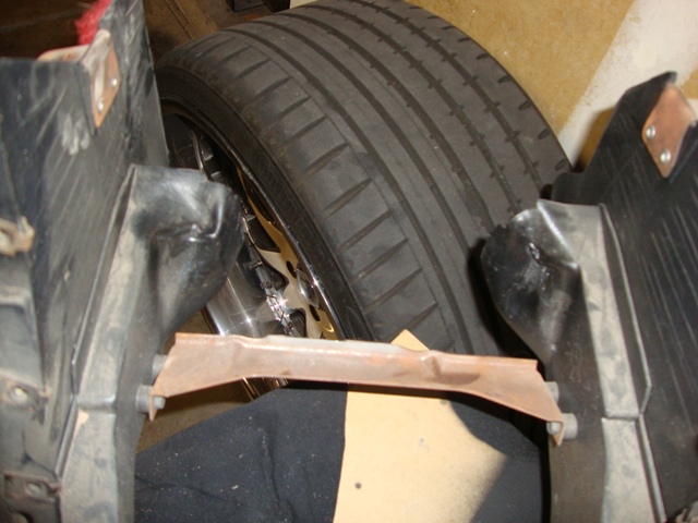

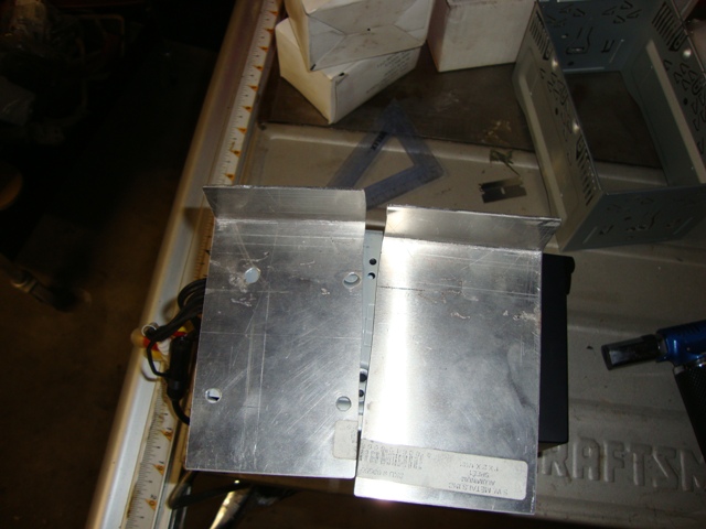

i used CA glue and baking soda to fill in the gaps. I made the brackets out of aluminum, had to shave the metal bracket in the back, as well as shave the bottom of the ac control panel metal brace but not remove it. also needed to form the vents on the back to accommodate the deeper radio size so it don't stick out so far. i wanted a more cleaner flush look

I did pretty much the exact same thing, here is mine
I created a tutorial on how to modify the bezel, if anyone wants to do it themselves.
