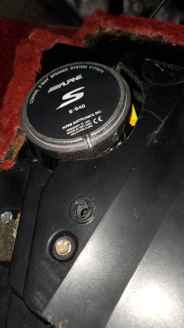

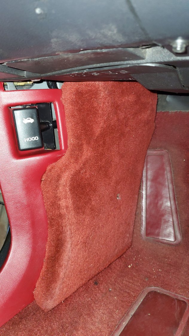

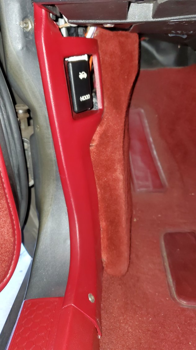

Time to replace the factory kick panel speakers.

The thirdgen Camaro is the only car I've ever found that exact speaker in..... I've never found another car that used that type of speaker.

I was looking at Crutchfield's website and found these speakers. They seem identical to the stock Bose units. They are 4" instead of the larger 4.25" Bose units and the rear of the speaker seems pretty slim but pretty sure it's also slightly bigger than the 1.5" Bose depth.

4 OHM vs 2 OHM BOSE; Mounting depth is going to be really important inside the kick panels too......
What was wrong with your original Thirdgen Kick panel speaker(s) ??

Got lucky as the amps at the kick panels were still good. The speaker was dead though. Replaced with Alpine. I did have to cut a circular hole behind the box so that the new speaker magnet could pop out a bit and allow me to seal the kick panel back up to look stock. The new speakers have made a big difference.

So you never used the "match" brand above? Id like to replace the bose speakers in the kick panels, but i dont want to have to cut them up if possible.
Honestly, I can't afford the speakers I mentioned above. I didn't want to cut the box, but I am not too concerned about totally stock anymore. I'm on the improving my car for the current times trip while keeping it looking stock. No one will be the wiser on the speaker box as the back end is hidden. I haven't inserted the center screw that secures the kick panel speaker yet, so I'll snap a pic if I can tomorrow.

Yeah, id like to see that. Are you sure the magnet wont contact the sheet metal? Those speakers dont look expensive, i mean they dont even have a tweeter.

What Alpines did you use ?? 2 OHM or 4 OHM ??

Here is the information for the speakers I used:
Alpine S-S40
  • 4" 2-way speakers
  • carbon fiber-reinforced plastic woofer cone with specialized rubber surround
  • 3/4" silk dome tweeter
  • handles up to 45 watts RMS (140 watts peak power)
  • frequency response: 97-22,000 Hz
The extra orange and green wires connect to the Infinity Kappa speaker on the dash. It's the same on the right side as well. I didn't use heat shrink tubing but will be going back to it when I fully secure the kick panel.
The speaker does come out a bit. I've owned my car since I was 19 and now 47, chances are slim to none that I will sell it. Hence the butchering of the factory stock sound system.

So the kick panel still attaches with the center screw? Is the magnet in contact with the sheet metal?
I do need to get a longer center mounting screw. As for the magnet touching the sheet metal, not really sure. I'm going to have to get like modeling clay to see how much it touches. and if it does, I have to get some sort of a non conductive spacer.

Most likely a spacer will be needed.
