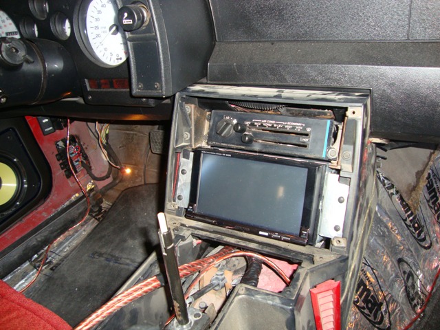

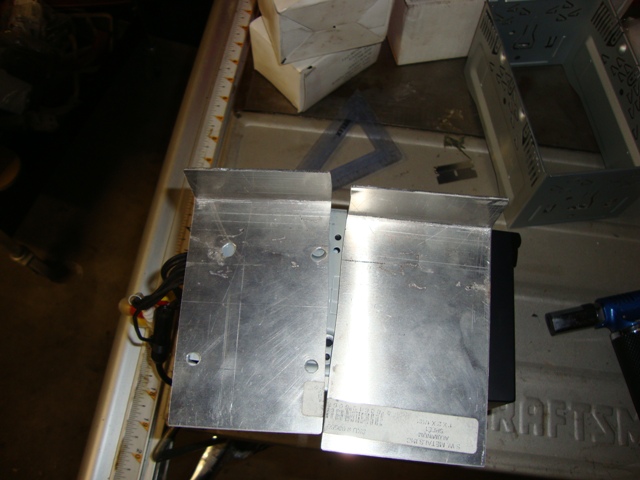

i started with aluminum brackets

Re: Double din bracket question
Im sure there is enough room and I will try it that way. Will be nice to see the fitment from beginning to end. thanks.

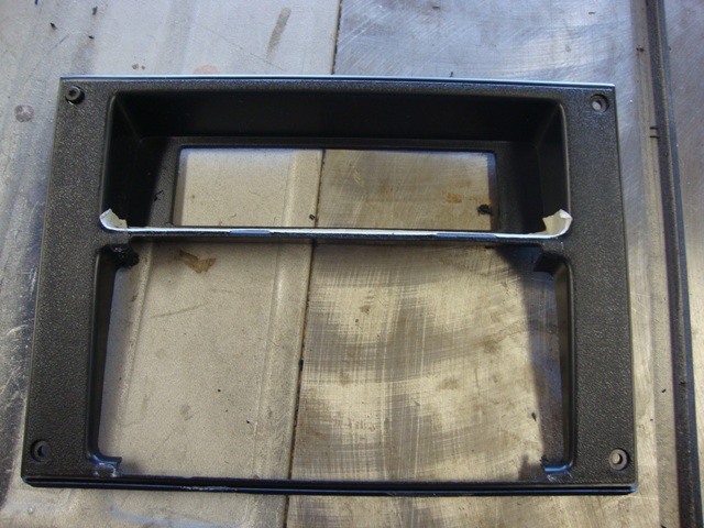

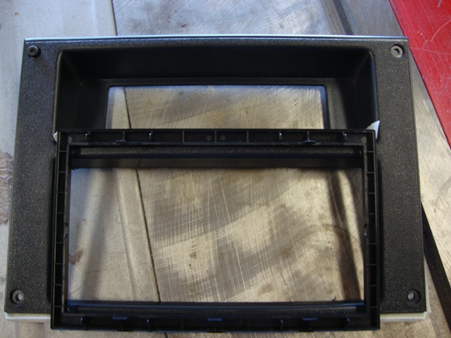

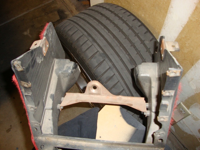

first cut off rear support tab, heated vents to accomidate depth of new headunit, glued alpine trim ring to dash bezel

routered bezel, filled in hole with abs and glue
thanks. really helps to see these things as they happen. Great job.
