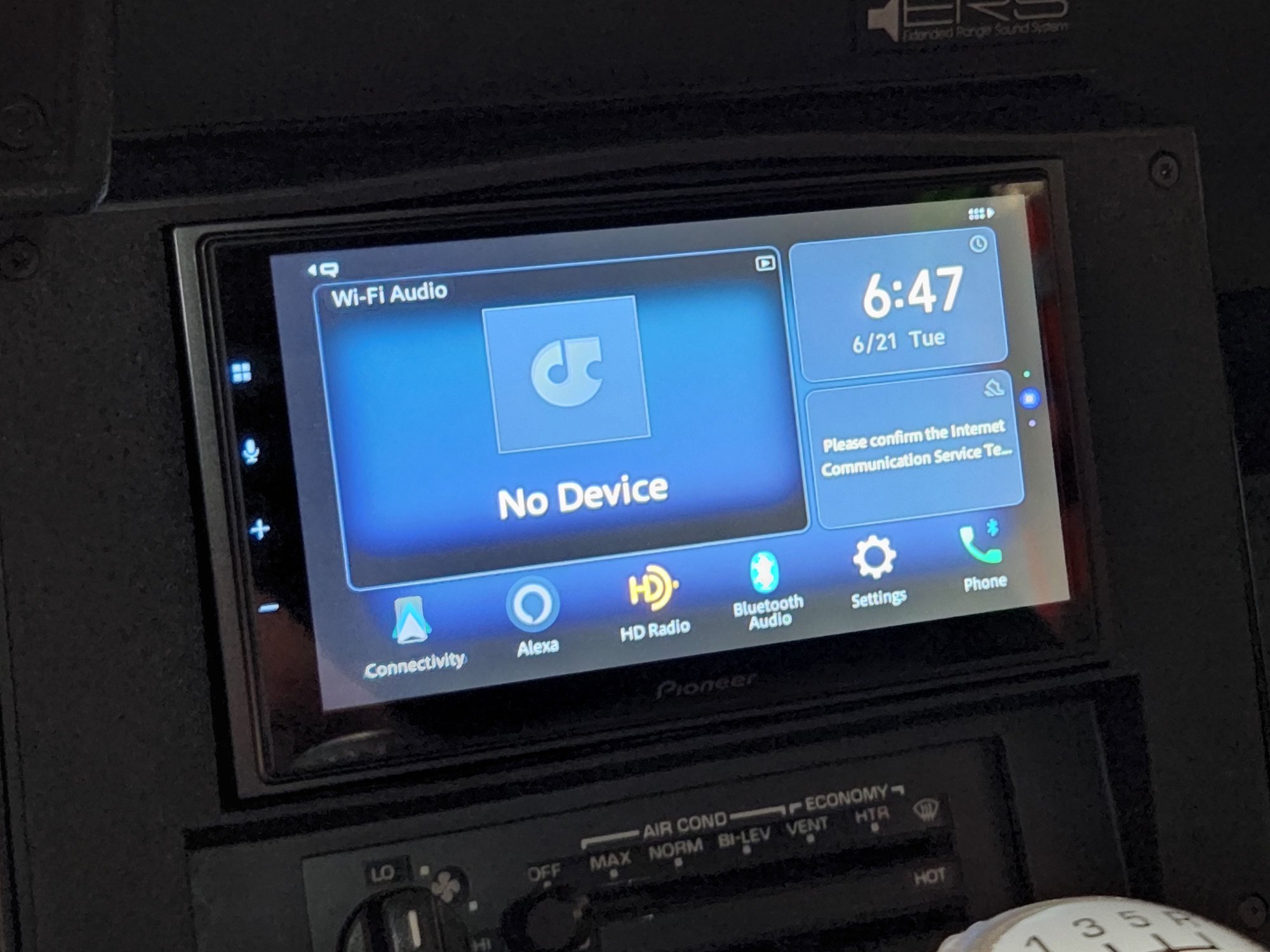

Hey guys- i run a pioneer DMH-W4660NEX. it is shallow depth version of the full unit. Fits in the upper slot great, ill grab some pictures tonight.

here are two pictures of this one installed. i need to massage the top mounting as you can see the face plate flexed a little bit

Looks good! My bezel seems to have a little flex, too... I hit it with a heat gun and gently worked it back to straight... that helped. I am curious how you mounted the head unit, though...behind the bezel. Did you make your own mounts?

Looks great, minus that bit of odd flex at the top. Is it pinched at the sides a bit?

Groy- i made my mounts using some galvanized lumber connectors from home depot- i think it was a 4 x 4 post anchor, i just cut the two sides off and viola you have 2 90deg brackets. And yes i need to get the heat gun on my bezel. My first install i had the headunit twisted slightly that caused the bow.

Yea, that was my initial thought... Thanks!!

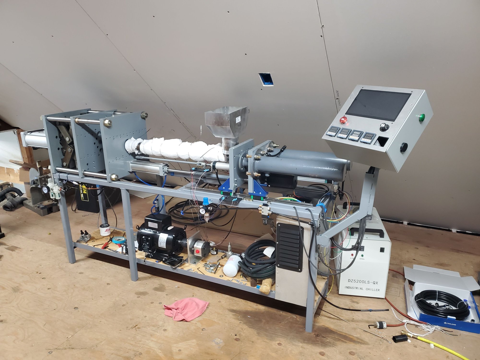

I'm looking to have the Camaro bezel ready for late spring. Firebird bezels I'm pushing for January. Switching from the urethane cast parts to plastic injection has been quit the project. Currently working on running the hydraulics on the injection machine. Then I'll be running some test runs on some cheaper test molds. I apologize for all the delays, it's been a long and expensive road but almost complete.
Here is how the equipment sits. all the air and electronics are functioning as intended. Just need to finish up the hydraulics.
