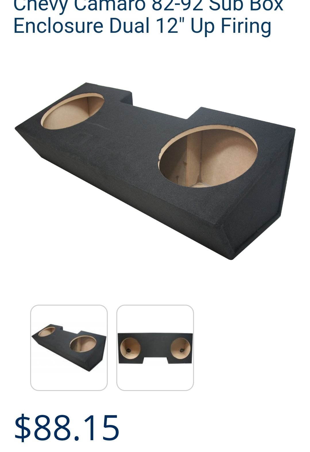

I understand your "free is free" and "it'll sound 50x better" logic for sure. -BUT! Are you able to sell the subs? For me, two12's would be a no-go for space reasons alone. For rock, you could easily get away only running a one 10". -Or even just running one 12". Just make sure you don't underpower
The space isn't too much of a concern. I never really use the trunk anyway, and after the box is installed I should have plenty of room for amps/capacitors etc. Unfortunately I feel a little too invested in the box to re sell it. Paid $88 for it a couple days ago. Pic attached if it helps gauge the space it'll take. It really only takes up the deep part of the trunk
