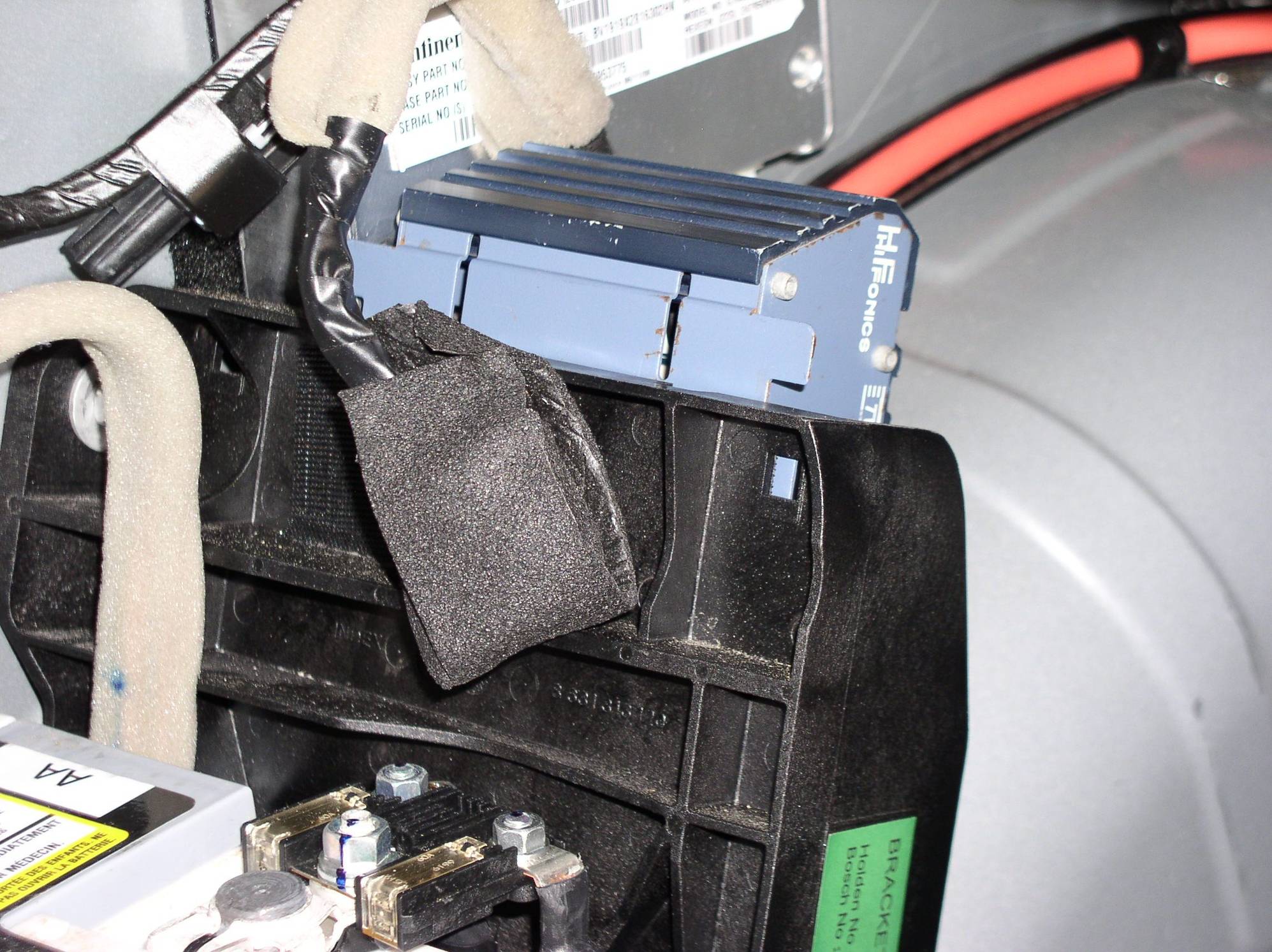

Love the old school Jed made in USA HiFonics - some of the cleanest and powerful amps ever made. I'm running Gen X amps in my 2009 G8 GT with a Pluto VIII bridged as a center channel amp (located in the stock amp's location)

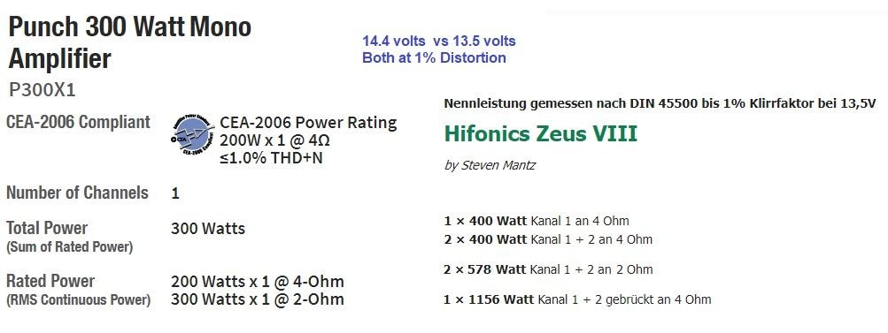

I love the old school HiFonics stuff!! Unless its actual old school ( like 20 years old) You are way better off getting a new amp. I was like you and using the old stuff. Had a ZEUS in my escalade pushing two 12" new punch woofers. The Cadillac dealer blew my amp and had to replace it. The stereo shop convinced me to use a new Punch Mono block 300 watt amp. When they installed it I was blown away! I am a stereo expert ( I was back in the day) And the power and clarity of the new amp was so much better I was shocked! And I just had my entire system done in my Firebird Head unit, Alpine speakers in stock location and one 10" JL sub in a custom box with a Marine 700 watt amp pushing the woofer. It is by far the best sounding and balanced system I have ever had In a car. And I used to compete in competitions. The new stuff is heads and tails above the old stuff. And the brands that used to be good have gone by the way side.

Assuming your talking about the P300X1 and your Hifonics amp was a Gen X or older, you cut your power to a quarter of what you should have had. If the new amp sounded better (no reason to doubt you), your Zeus was either wired incorrectly or something was wrong with it long before it blew - my guess would be the capacitors going bad over time. However, the new amp does have built-in adjustable crossovers and bass boost controls that the Zues doesn't have and that could have helped out some - just 6dB difference in output should have been noticeable in a non-favorable way.
