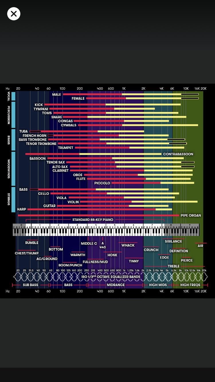

In layman’s terms, cause there’s guaranteed to be someone smarter than me.
1. The claim that a 6.5” driver may require 1/2 cu ft is a bit excessive - but * IF * you’re running the woofer full range (80 Hz - 8KHz {Dyno Dave has deep pockets, buys good stuff}) a larger enclosure will definitely improve the low frequency performance. If mid bass is the goal and you’re willing to set a crossover (12 dB +) to block lower frequencies to get it, then you’ll be quite happy with a smaller enclosure like a kick panel. Attenuating the lower frequencies will reduce woofer movement and in turn make it act like a smaller woofer. It’s all about air movement, the smaller the enclosure the harder it is to move air into it.
2. The factory enclosures worked because the “woofers” were tiny.
3. Absolutely. Reducing the cone area has the same effect as enlarging the enclosure, extending the range of a woofer’s performance.
Attached pic will give you some indication as to what you’ll be giving up. Frequencies 150 - 400 Hz are what add the warmth/fullness of music.
