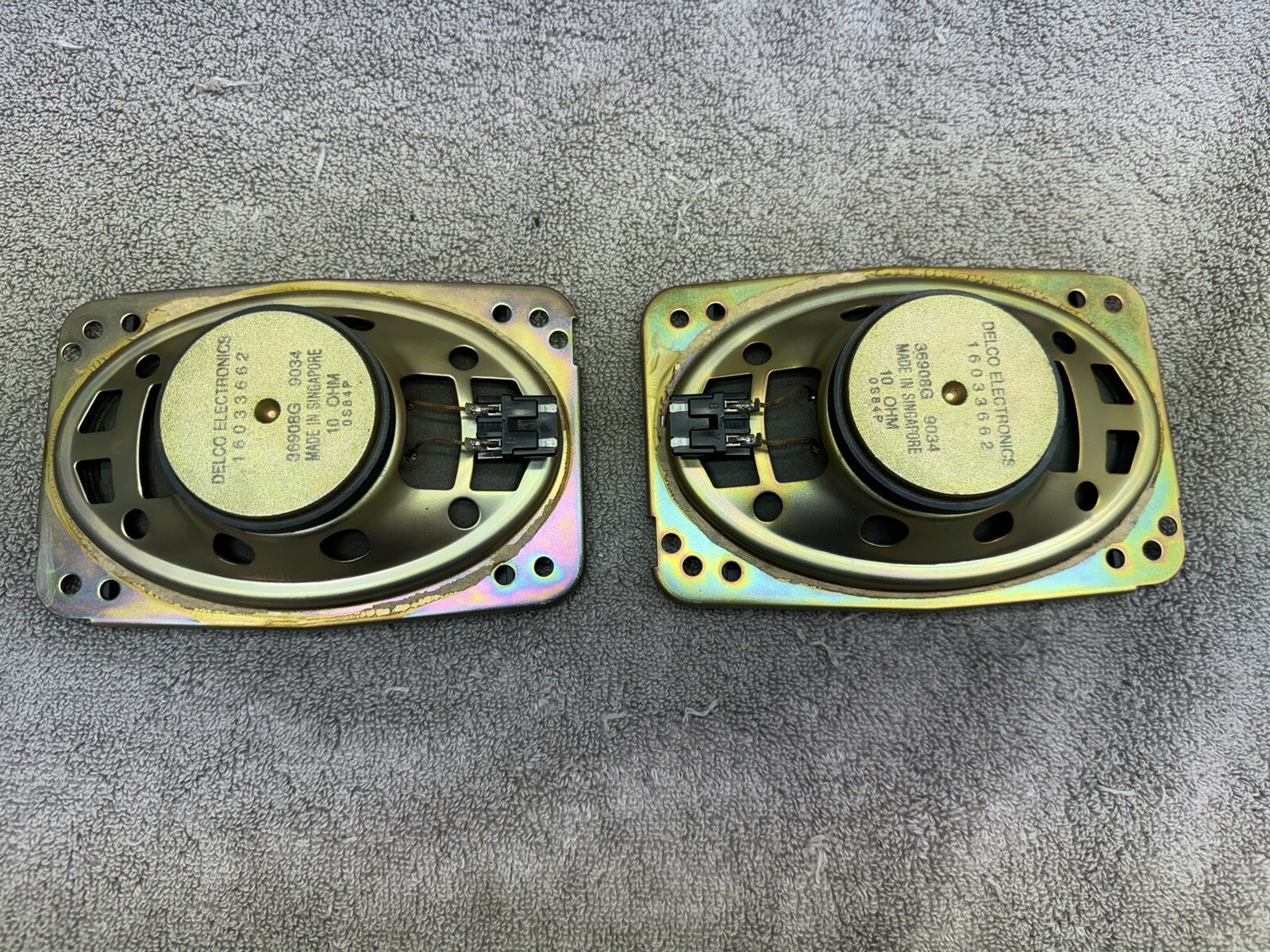

Original 4x6?
Does this look like the original front speaker from '89?
what ohm are these?

Re: Original 4x6?
they look original-8832 date code is 32nd week of 1988, these are usually 10 ohm,sometimes 4 ohm.

Re: Original 4x6?
I've seen Japan around here. My1990 factories were from Singapore and say Delco Electronics. https://www.thirdgen.org/forums/elec...ml#post6330536

Re: Original 4x6?
Yup,..... Those fronts should be 10 OHM.
( 4 OHM 4x6s were only used in Pontiac F-Bodys as part of the UQ7 subwoofer system & mounted in the REAR speakers boxes. Those cars also used 4x6 10 OHM in front too like all other F-Bodys. )

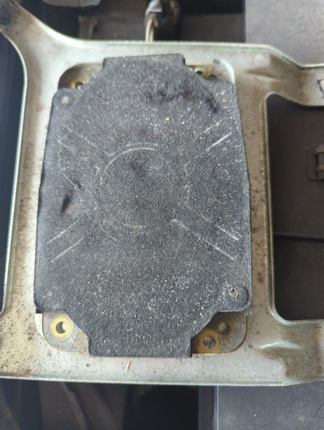

Re: Original 4x6?
Ok, 10 ohm.
Here are the rear 6x9. Again I assume original and obviously 10 ohm.

Looking through Crutchfield catalog, I only see 4ohm replacements. What do you guys think about using 4 ohm instead of 10?

Re: Original 4x6?
Don't do it: ( watch the video )
https://www.thirdgen.org/forums/car-...ml#post6336618
Edit: Factory head unit can power 1 4-OHM and 1 10-OHM on each channel (L-or-R). Some/Most Pontiacs used 4 OHM rear 6x9's. Connecting 2 4-OHM speakers to 1 side (L or R) side is not advised.
