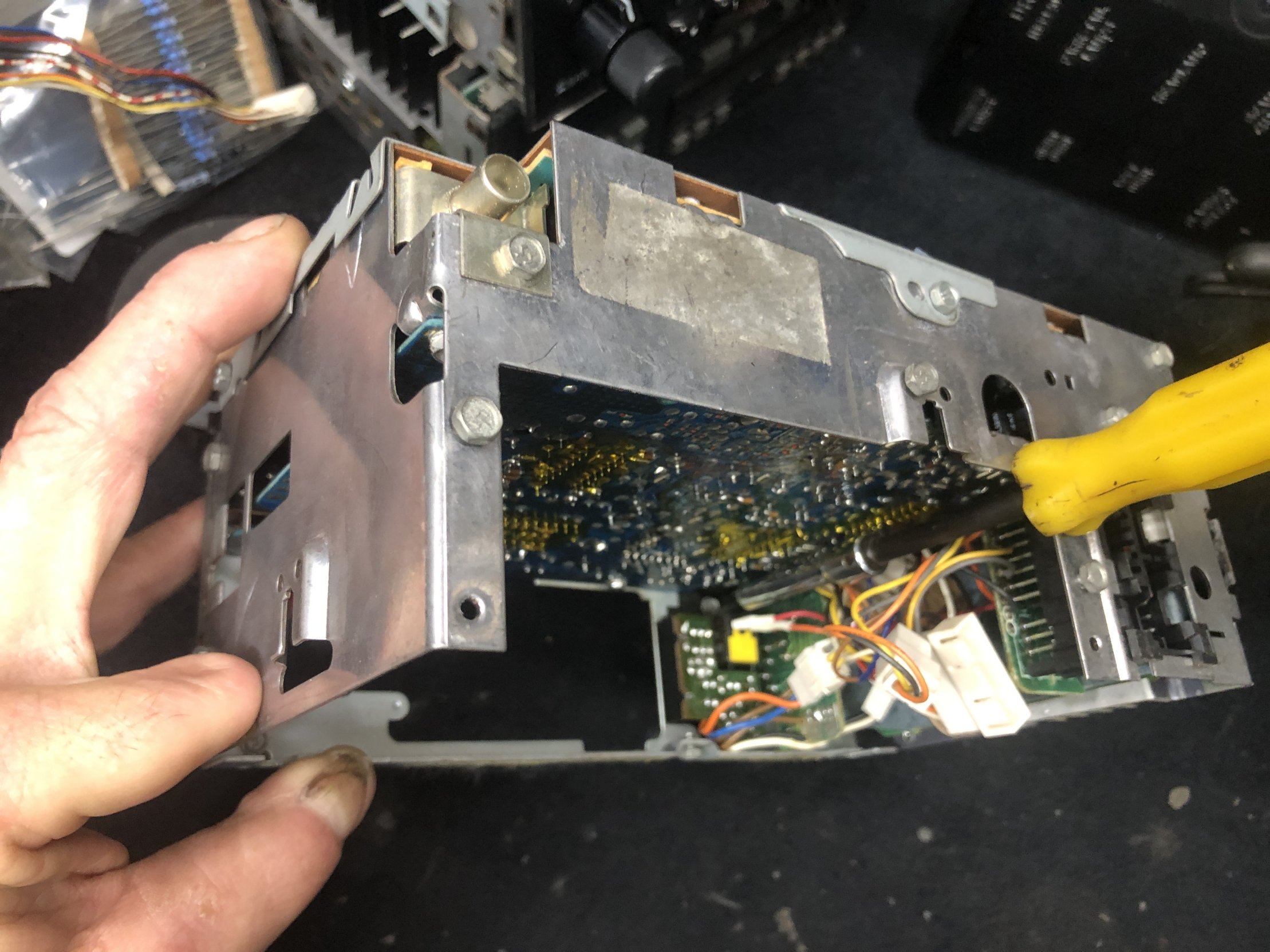

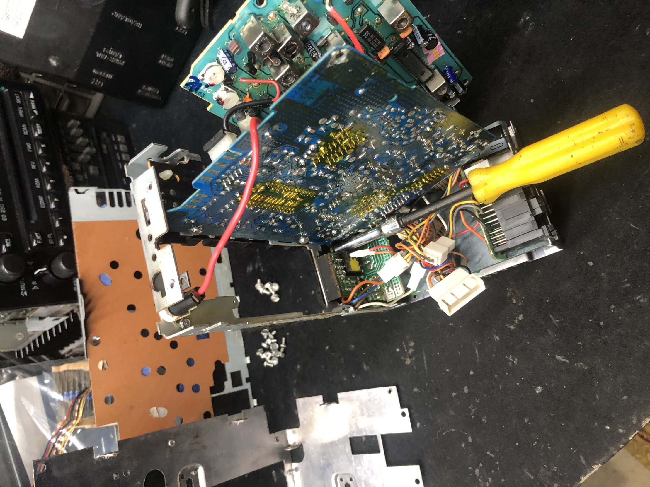

@JT: The power button isn't too hard to swap,.. depends on how "detailed" a person is.
The bottom of the radio case has to come off and the cassette mech has to be removed in order to access the Power switch inside the radio. ( some UX1 radios have a cassette mechanism that uses a small screw in the front corner of the radio that has to be accessed thru the side. Sometimes this is a philips-head screw, but many times it's a tiny 3/16 hex head. ) You can leave the faceplate installed and only needed to remove 7 screws so far........
From here you can remove the 3/16 screw holding the power button secure with a thin-walled, deep-set 3/16th socket. At this stage this screw can be kinda' a PITA to get a grip on and at this point you should decide how "detailed" your gonna' be: There's limited access to the wiring so you can only cut/splice the 2 wires for the power button. So; if your OK with cutting & splicing the wires and don't mind "fighting" a little to remove and install that screw,.... go for it - done !
If you prefer to solder the 2 wires in place.: Remove the 3 screws from the top of the radio case, remove the 4 1/4 screws from the circuit boards at at the top of the radio, remove the 5 screws from the side/back of the radio case (1 of those 5 holds the circuit boards near the antenna port ), look at the radio from the bottom and remove the 2 1/4 screws from the bottom radio circuit boards, and final step is to look at radio from the front and remove the 2 long 3/16 screws that hold the bottom circuit board to the front/face radio bracket. ( screws under the preset buttons ) and this is what you'll see,....... it took me 2 minutes time to progress from picture 1 to picture 2.
You can just allow the circuit boards to "float" and you will have real easy access to the screw holding the power button in place, PLUS you can access and solder those 2 wires properly. There is even 1 more small bracket at the back/right corner that can also be removed to allow even greater access for soldering work if you need the extra room to work.
