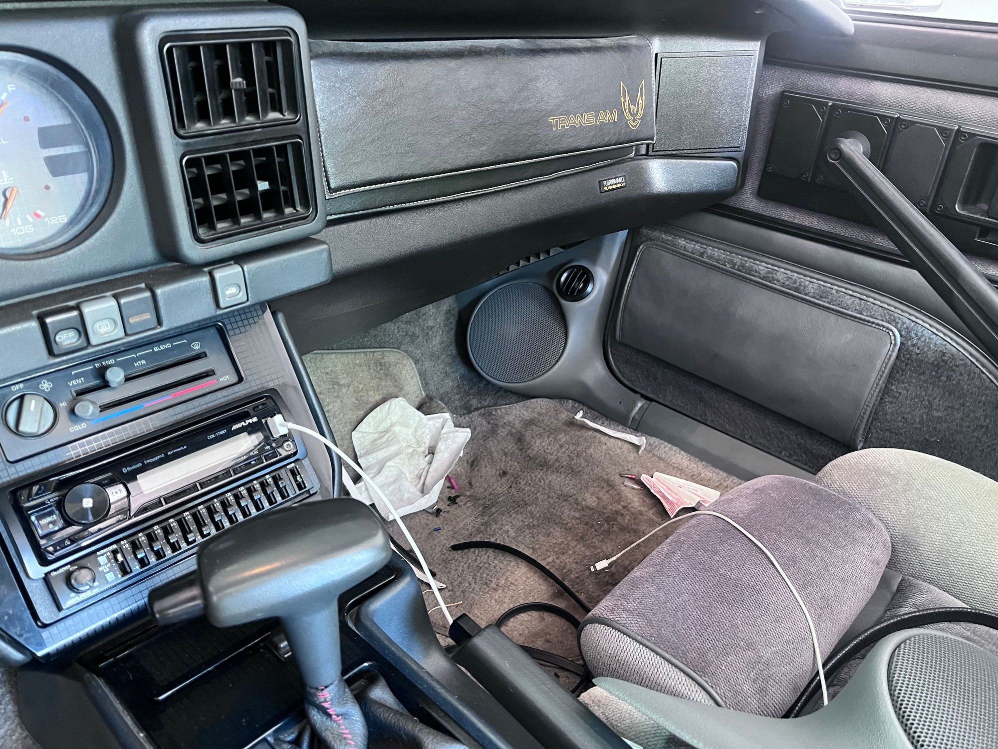

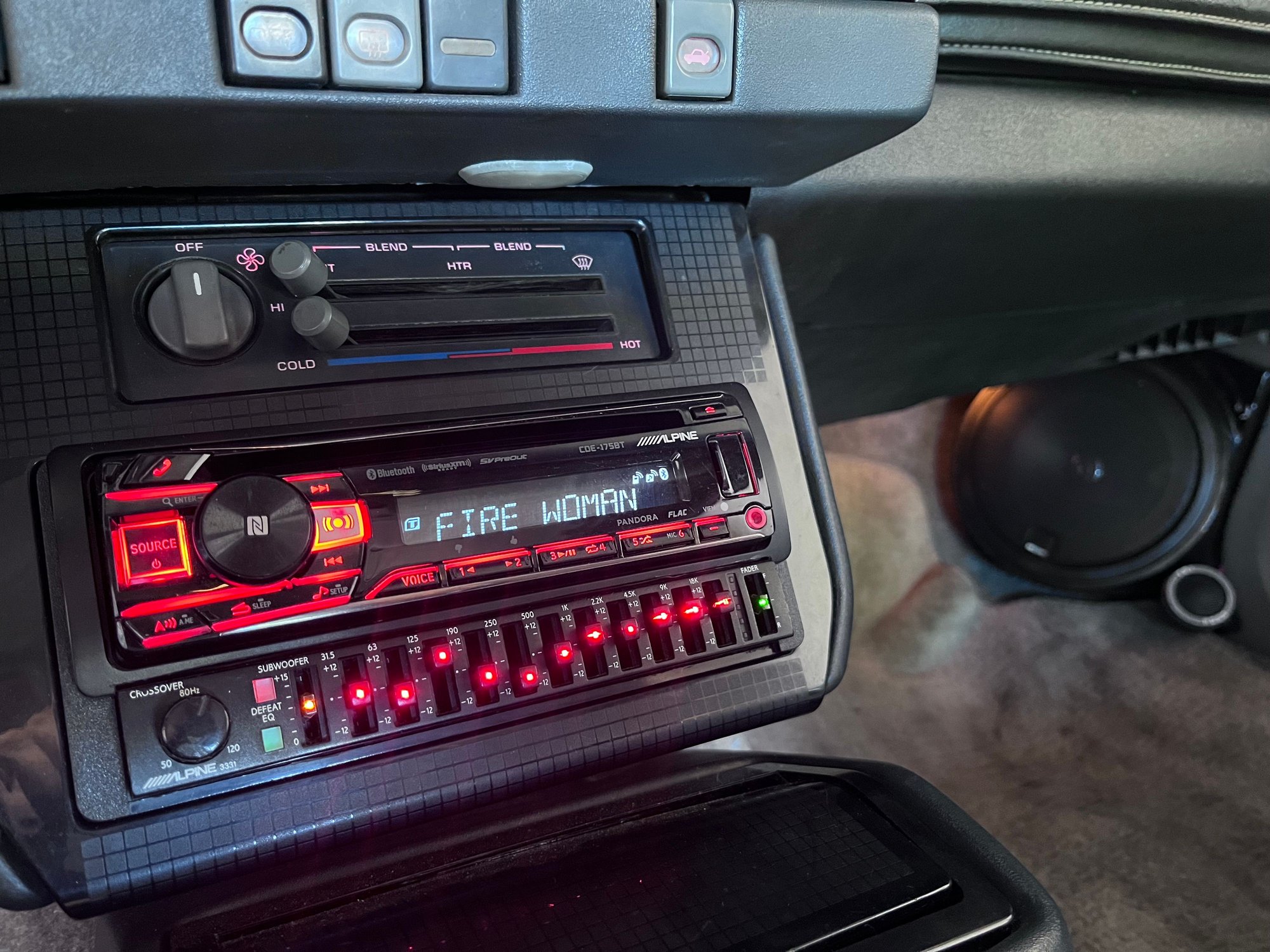

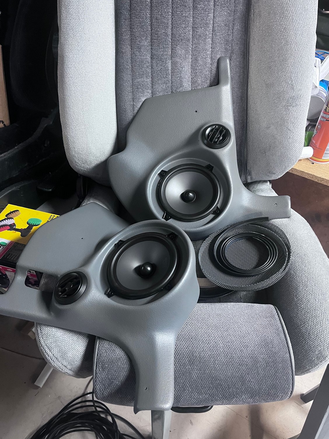

QForms & 5.25 separates
Old Jul 9, 2025 | 05:23 PM
theraymondguy's Avatar
Joined: Jun 2020
Posts: 490
Likes: 116
Re: Tuning a Third Gen T/Top car stereo
Panel color match is good. Pull hush panels for simple install. Do not permanently mount mids until ready to install grill. Fit of the kick at sill plate leaves something to be desired.

Originally Posted by theraymondguy

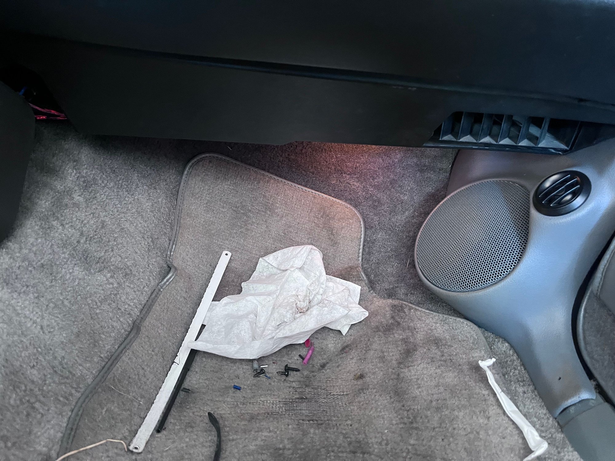

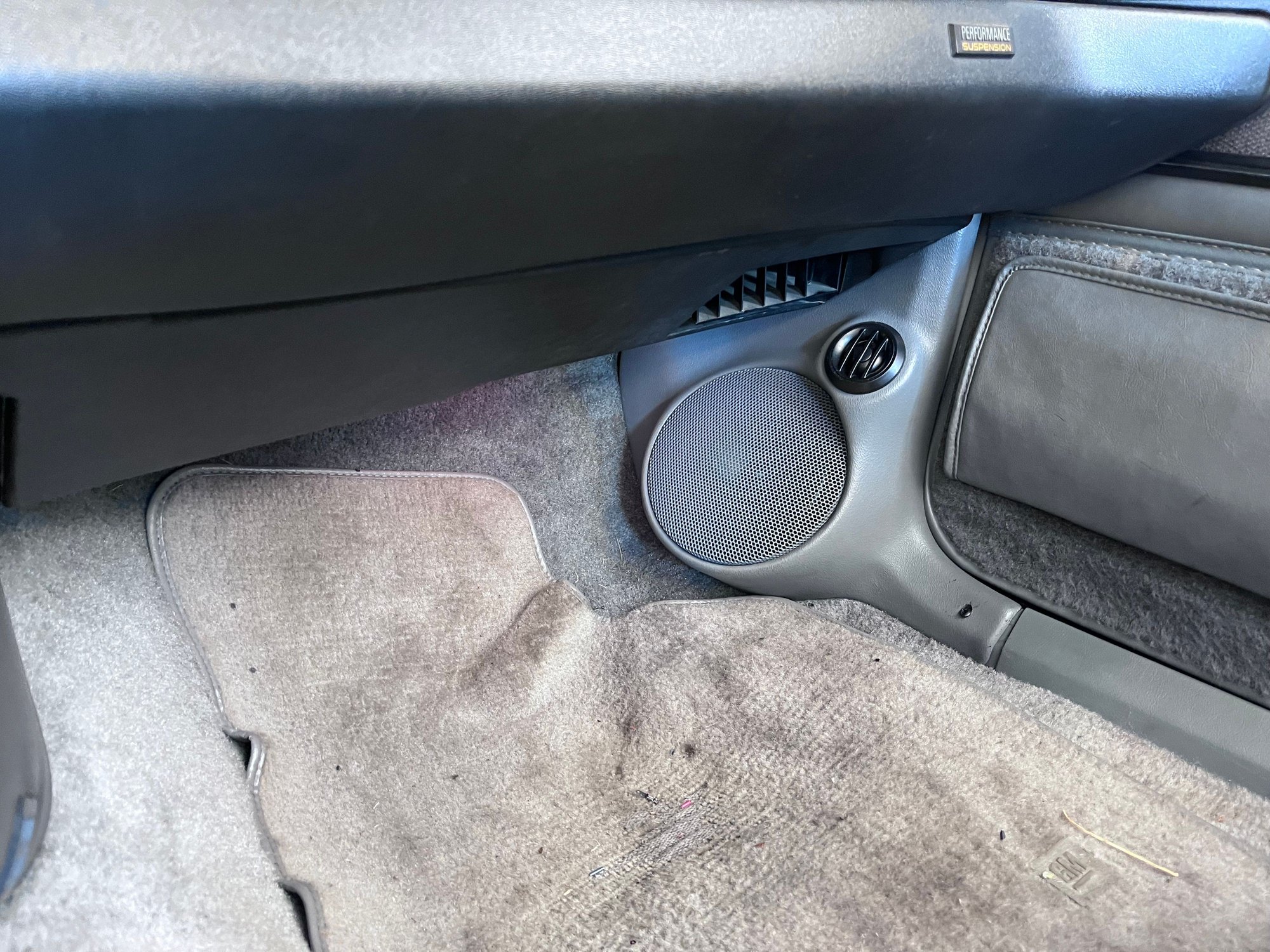

I was thinking about q forms after seeing the other thread and how they are still being made. Have you put the left one in yet, how bad do they encroach into the foot well? That current setup looks ridiculous, where does your foot go?

Looks great. Do you have photos of the driver side?

I have them both in, but I feel like I should do a thread on these by themselves. I want to do them justice and make sure I maximize the install before judging their performance.
As it stands right now, the “Absurd” diy setup does sound better (keeping in mind diy was 6.25, everything on axis, I’ve not run the logic’s tops installed as yet.
Quite a bit of fitting required for the Q logic as well. I’ll grab pictures tomorrow.

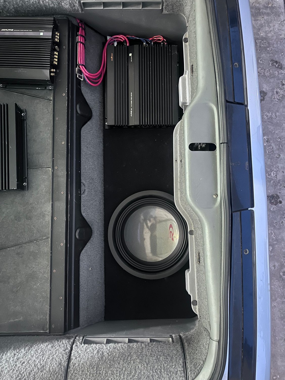

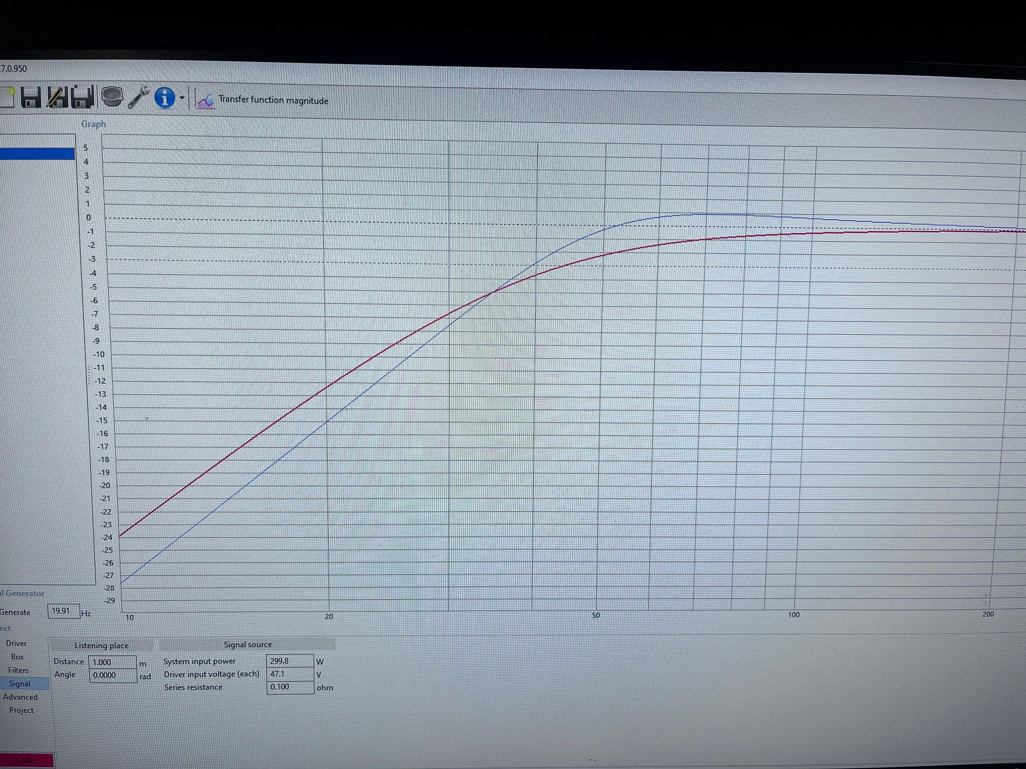

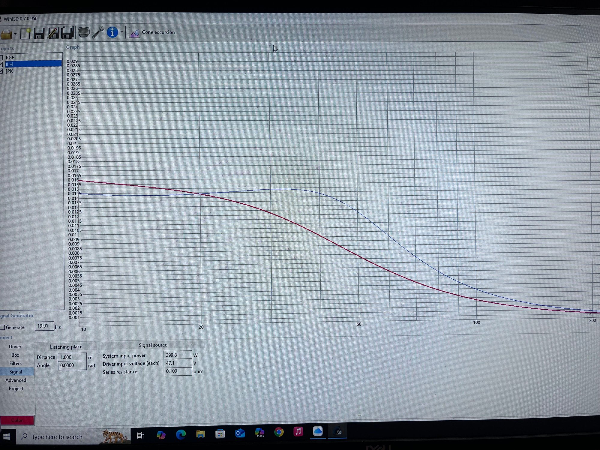

The Alpine SWS 1043D sub had a huge bump at 50-70 Hz and a massive void below.
The solution appears to be an Alpine SWR 1223D, yes it fits just right into the trunk well box from the sticky (about 1.1 cu ft).
Win ISD, 12” in red (flaaat) 10” in blue
The 12” wastes no energy.

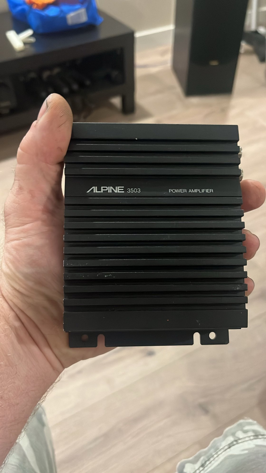

The old battered 3554 is stil the best match to this setup.  I’ll run my little 3503 for the tweeters when it goes active.

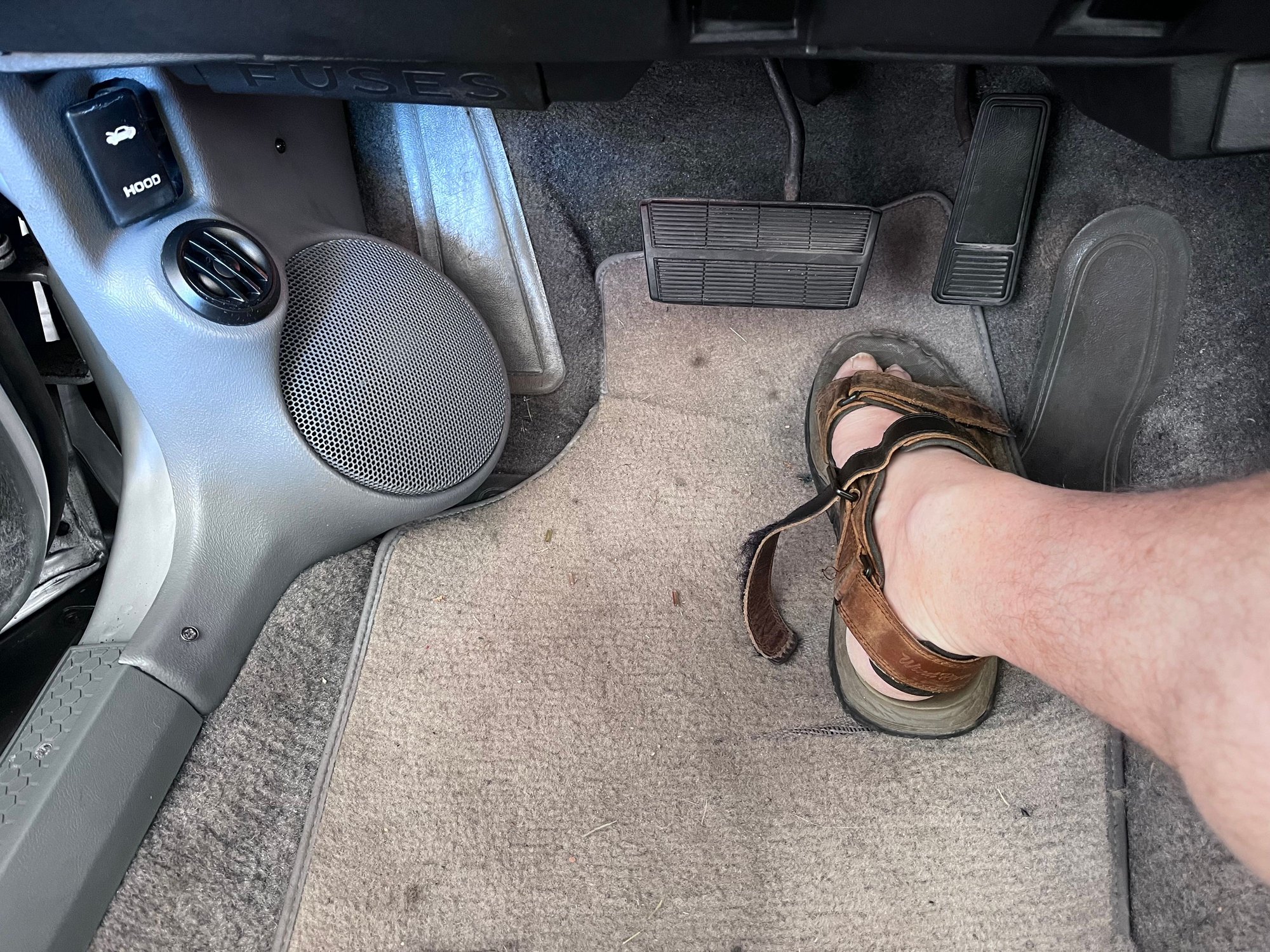

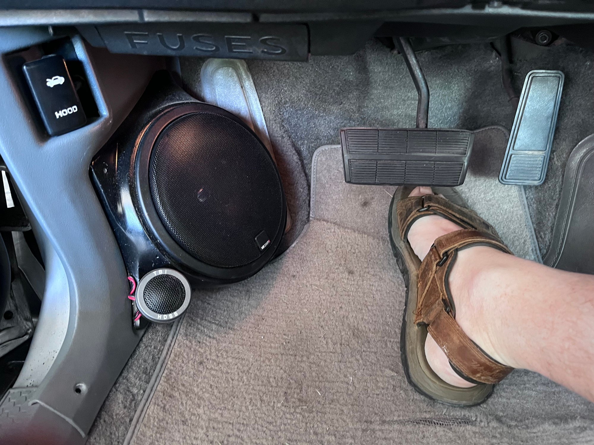

Taken with camera lense centered at lowest apex of wheel.
Old Aug 1, 2025 | 09:45 AM
VicsGarage's Avatar
Joined: Oct 2024
Posts: 43
Originally Posted by theraymondguy;[url=tel:6568063
6568063[/url]] Taken with camera lense centered at lowest apex of wheel.
can you rest your foot comfortably on drive side?
