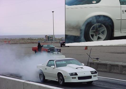

Thanks again I could keep this up all day but I'll leave it with this last one.
Sometimes I get carried away with my burnout ...
