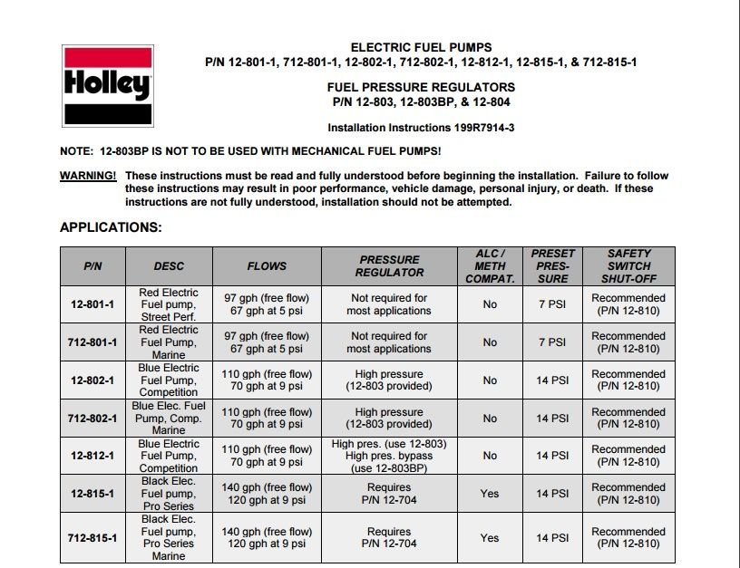

All of the by-pass style regulators I checked out specifically mention not for use with mechanical pumps. That said, I overlooked the Mr Gasket 2015 however, as you point out, Holley and Mr G are joined at the hip now. Holley's 1284 looks very similar to Mr G's 2015 and the 1284 is for electric pumps only.
Holley 12-803BP. Presently installed but not yet tested with 3/8ths supply and 1/4" return. It didn't work in that configuration with either of my mechanical pumps.
Perhaps this is Holley's version of the Mr Gasket 2015?
Looks like Holley's 12-841 (without the anodizing).
I have Holley's 12-803BP and it says not for use with mechanical pumps. I tried it with my Carter mechanical pump as well as my Edelbrock 110 GPH pump with no success in either application. I will say that I'm using the small 1/4" return line as my return although as far as applications go, the mechanical pumps and the electric pump I have (a Holley Blue) can all be dead-headed. Still, by not following the instructions as in the return line being the same size as the supply (3/8ths or -6 AN), I've brought the trouble onto myself.
And this was the original question in this thread.
