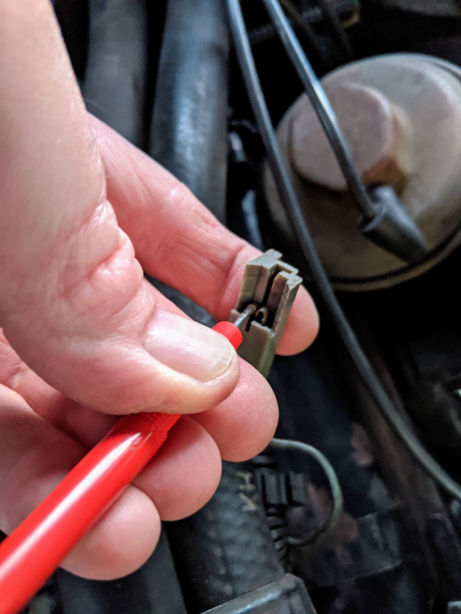

So I have the old "Choke light stays on" issue. '83 Z28 LG4, stock Rochester E4ME carb.
Choke plate doesn't want to stay open even when warmed up, and car idles high, around 1500-1800 rpm... Sometimes when I manually hold the plate all the way open and goose the throttle the plate will stay open and the idle will kick down... but other times the dang choke closes a little and the idle stays high. Worst part is if I shut the engine off while it's idling high, she diesels BADLY.
I checked the alternator: Battery has 12.7V with car off. 14.15V with car running. 14.2V car running and lights on. Gages fuse and C/H fuse are good. With the choke wire disconnected (please see picture) meter is reading 14V... however, when wire is connected to the thermostat tab, I only get about 2.58V. at the tab. So I guess the thermostat is probably the culprit?
I would just like to be relatively certain that I am replacing the right part... thanks for your input.
