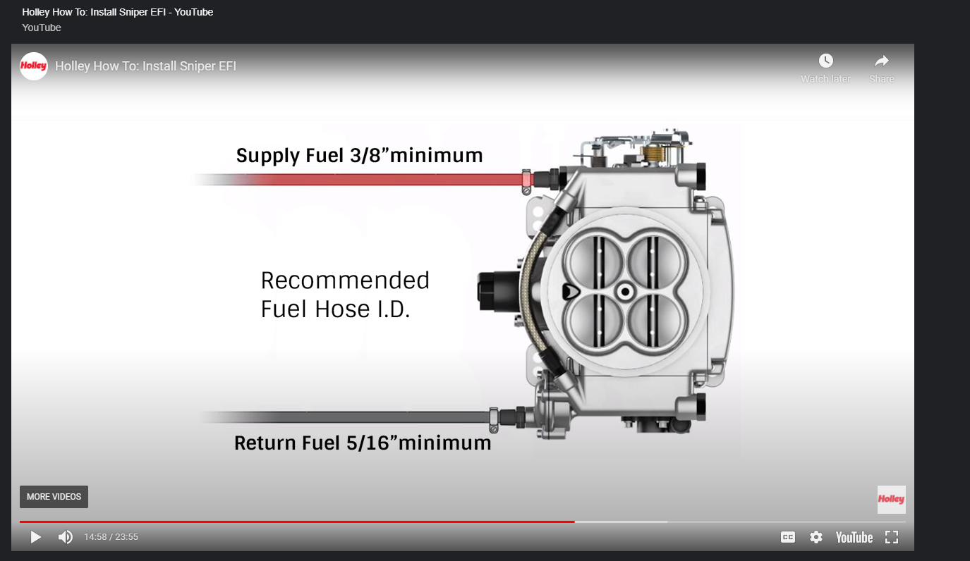

I just verified with Holley on the installation video that minimum requirements are 3/8" supply and 5/16" return.

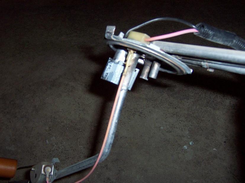

the fuel tank will usually continue to push fuel through the supply line at the fender well when it is opened. relieving pressure on the tank by cracking open the fuel cap will usually stop it.
if it continues to siphon, clear the fuel out of the line with an air hose.
the return line does dump into the top of the tank. I've run a fi tech through these steel lines (connected with flex to the fitech) with no trouble for thousands of miles. I used a walbro 255 in-tank connected to the stock pickup on an 87, which came from the factory with an in-tank helper pump.
I would recommend the in-tank pump option using as much of the steel lines as you can.

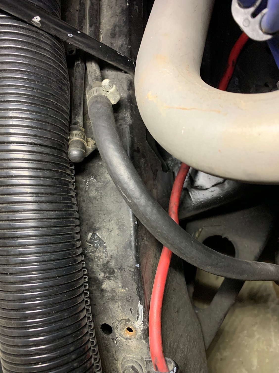

Where is the return line in the engine bay? Was it over by the charcoal canister?

Took a look and found vent from charcoal canister on drivers side and return directly below
Return
Charcoal vent
