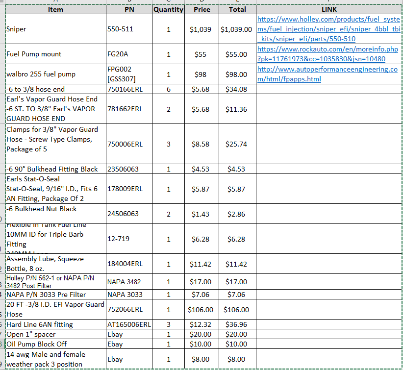

Fixing cold start issues was a major driving force behind going sniper. Temps range between 40-105F when I am starting my car in the spring and summer so I wanted something that would adapt. With the sniper I turn the key, wait 2 seconds for the pump to prime and then it just starts. I did do some tuning to the temp vs idle speed and cold start enrichment tables but the stock stuff got me super close. No regrets on the sniper I got more HP, 4MPG and way better driving, starting and idle. I tuned the carb with a wide band and a vac gauge but sniper was the way to go. I do recommend the progressive linkage so it only opens 2 butterflies under 40% throttle with all 4 the car was a giant pain to start in 1st without burning out.
For fuel I used a 1992 TPI tank pickup and a walboro 255 pump. 3/8 line and return with the built in fuel pressure regulator

After my car sitting all winter it was 45F out I turned the key waited 2 second for the prime and the car started and idled no problem and drove away a few seconds later like a new car. With my carb that was a few minute procedure. Honestly the sniper was my favorite mod even my wife who knows nothing about cars was blown away how smooth the car was and how much more power it had. I spent a long time tuning the carb with a vacuum gauge and an A/F meter and I thought it ran great. I was no where close. When I swapped to 1.6 rockers I noticed the tune was unhappy. I reset to the base MAP and about about 6 minutes of driving it was back on track ready to go again. Super easy. The only mod I recommend is the progressive linkage so it acts like a 4bbl carb with mechanical secondaries. This list might not be perfect but it is damn close to what I needed in the end. I also added an inline pressure gauge.
