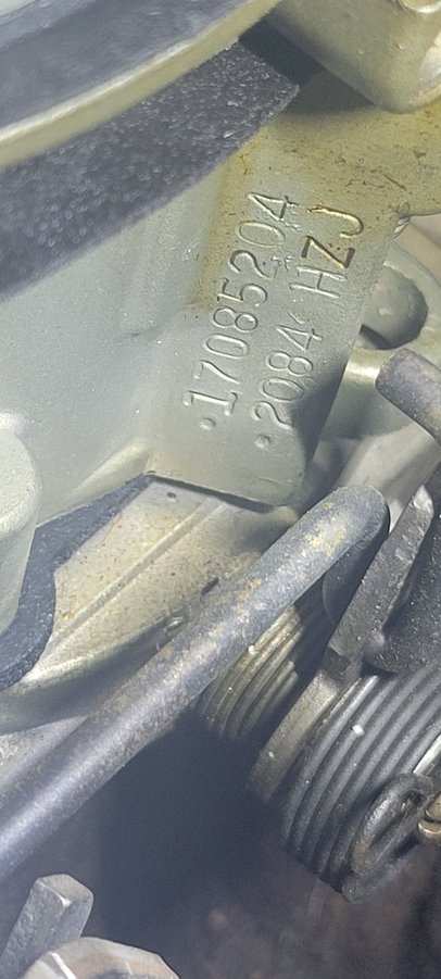

Not sure where I got the other number. But here's the right one.

Re: 86 Camaro Qjet
OK den, that's for a 85 auto car. Probably missing a bit or 2, maybe even with acoupla extra little bits. Butt hay, we can work on that.

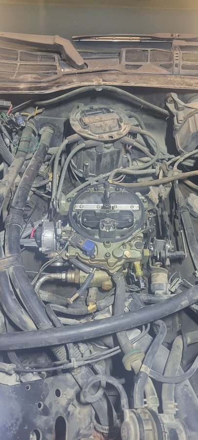

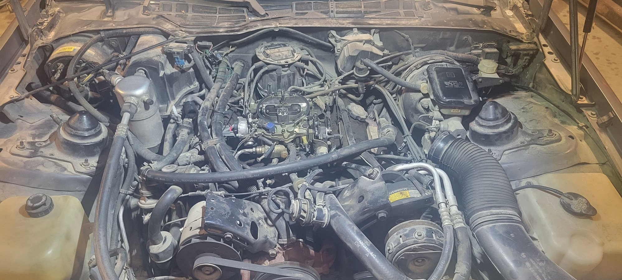

Get a photo somewhat somewhere more nearly like about this.
Maybe a shade farther away so we can see the rest of the wiring and sensors and whatnot all around the scene of the crime. But close enough to see all of the connectors to the carb and what's plugged into them, and its vacuum lines, and stuff like that. Let's see what we're working with.

Re: 86 Camaro Qjet
