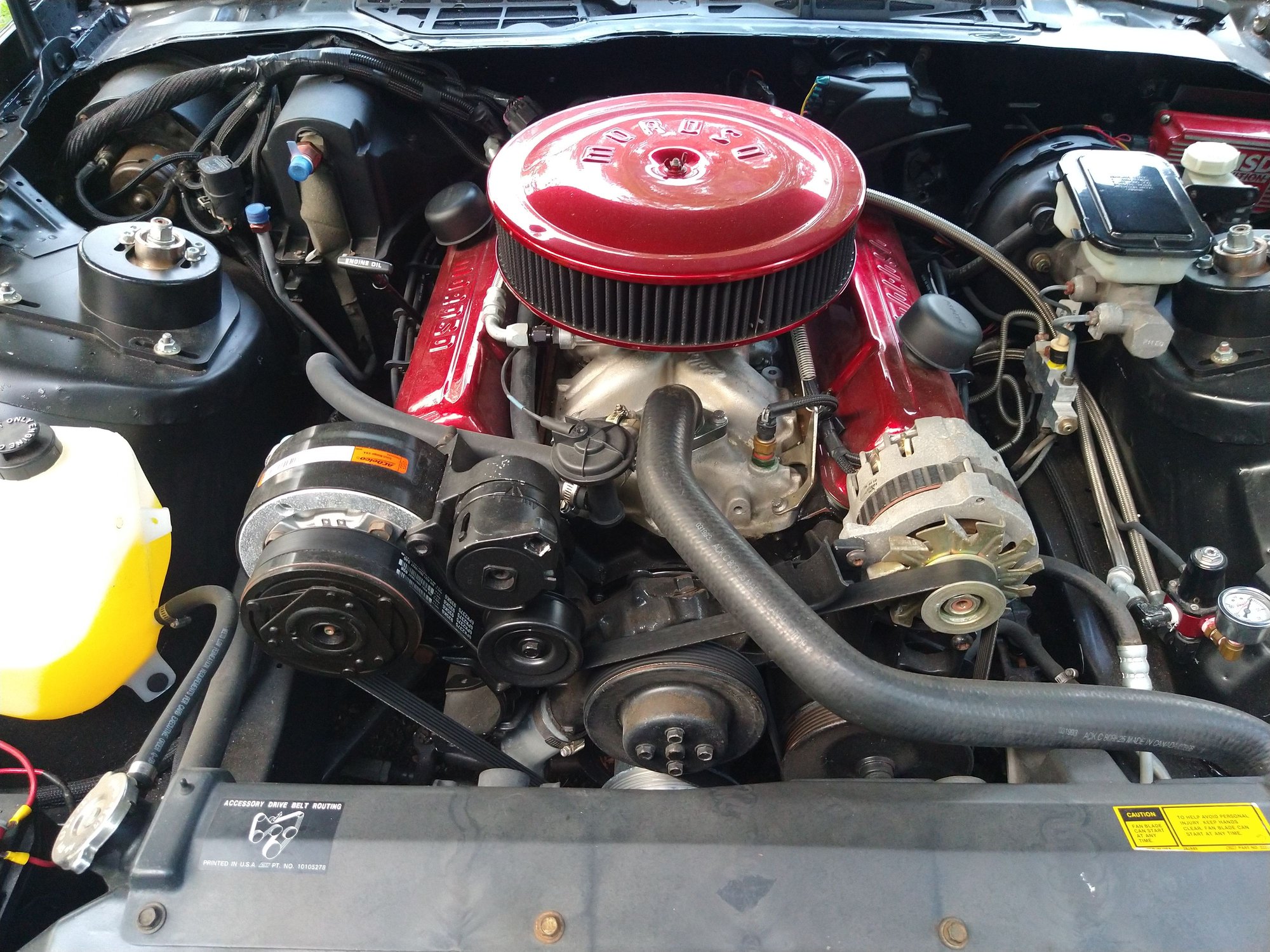

Yea all cars have there own troubles. The paint looks amazing in photos but isn't to spectacular in person. Still have to learn how to buff the paint job.
Here's more pictures tho!
I'm trying to get more up but iPhoto doesn't like to work lol

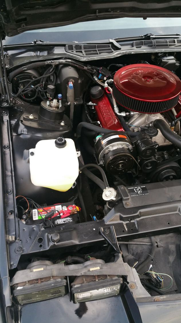

Finally was able to get a picture of the engine uploaded. This was taken before everything else was hooked up. Updated pictures to come shortly

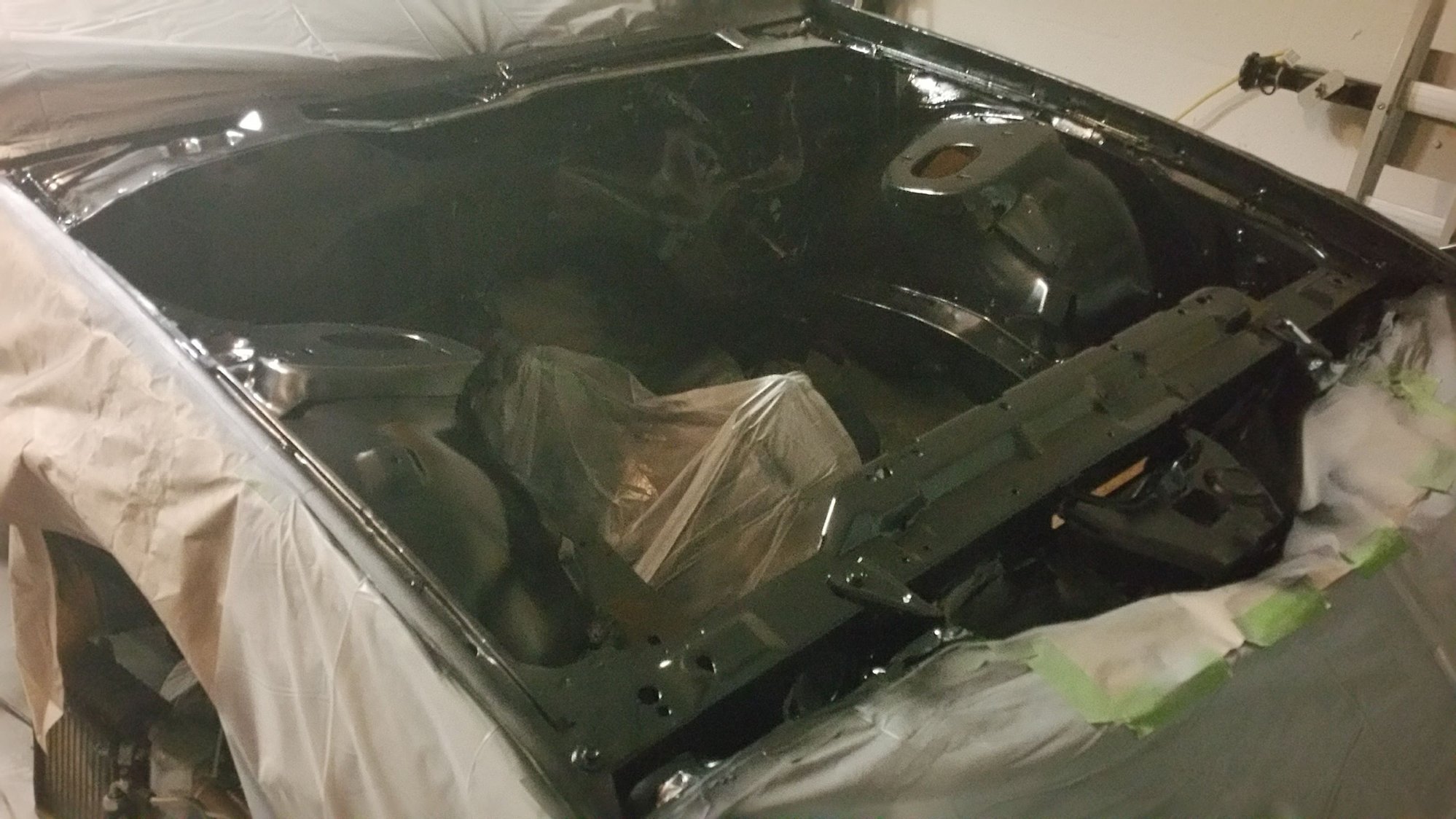

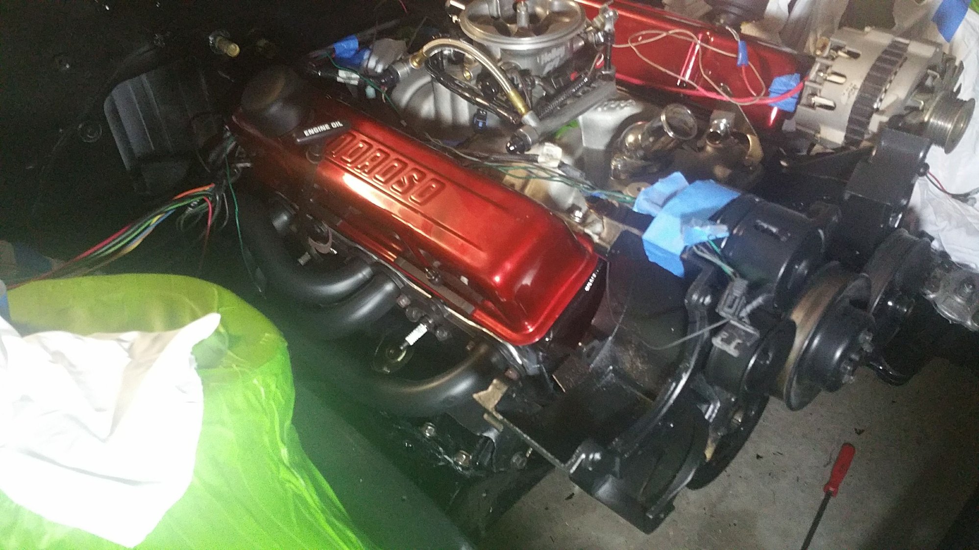

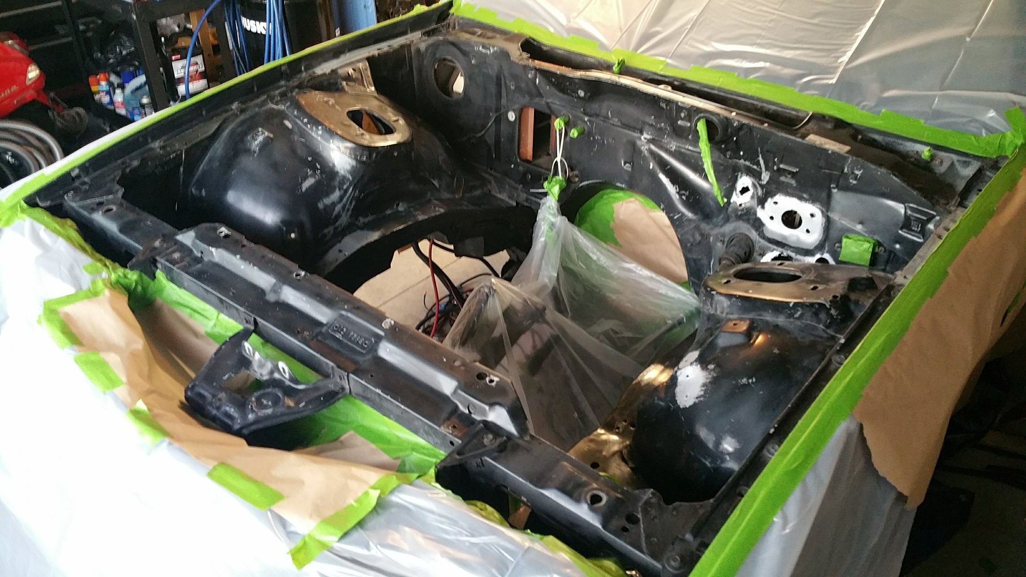

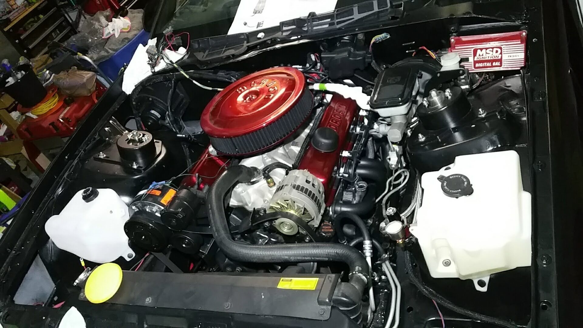

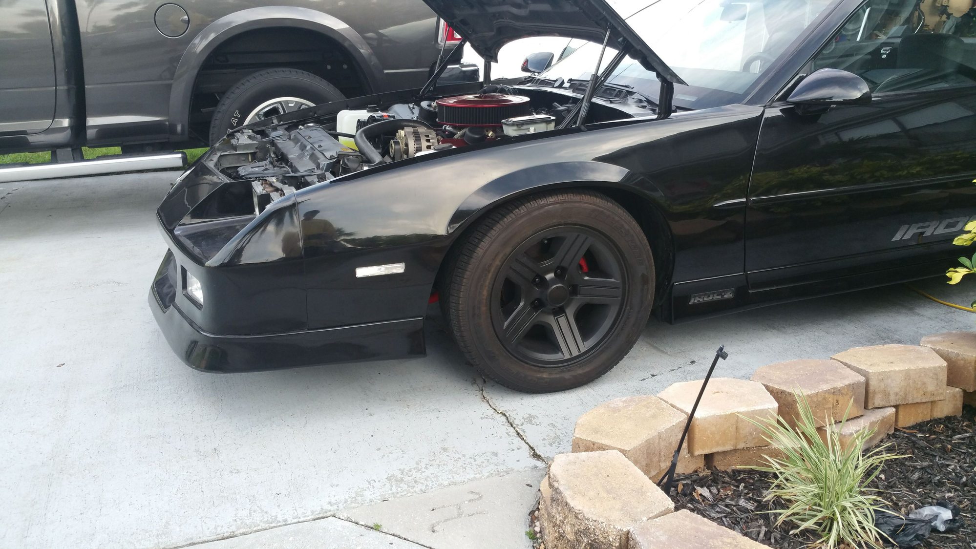

Finally got around to adding real pictures to my thread. Build threads are boring without pictures. Also the car is up for sale so check the for sale thread soon as it'll be there sadly.
Good news tho is that I just had the transmission rebuilt by tick performance and it shifts like butter.

So its been ages since I have updated my finish thread. I have done a good amount since the last update. The holley terminator EFI is up and running, and I installed a small cap distributor along with the MSD 6AL box. The computer controls the timing and fuel. It is worlds better than the carburetor on the car before. The only negative thing I have to say about the EFI system is the back light on the screen of the hand held died which made the screen virtually unreadable except at night. The only way to fix the issue was to purchase and replace the old unit with the 3.5" touch screen hand held. The EFI system has hardly no time on it and it sat inside a garage it's whole life so I know its a product issue, as Holley stopped sending the small hand held, and now only sends the 3.5" units. The issue is fixed, It was just more money I had to throw at the car.
Last year I removed the engine and transmission to redo my engine bay. The engine bay started looking like a hack job with wiring, the front suspension had surface rust, and the engine bay paint was scratched everywhere. So I removed the front suspension, painted the control arms, k member, power steering pump and some other pieces black with rust bullet paint to make it look better than new. The sway bar and wonder bar were painted with red rust bullet paint to match the rear suspension pieces. I wanted some accent colors on the suspension pieces while keeping it looking stock.
While the suspension was out I installed Eibach lowering springs, I forget if it was the pro-line or the sport-line, and I left out the front rubber spacers. The car is super low to the ground now, so my plan is to make a new air dam out of a tractor trailer mud flap as the current one brushes speed bumps and when I pull out of the drive way each time. To clean the engine bay, I put a tarp under the front half of the car after everything was removed, washed and de-greased the whole engine bay before I sprayed down primer and gloss black paint. All the pulley accessory brackets, windshield motor pump, msd bracket and other small things were painted flat black to clean up the bay and the air pump was removed since it was no longer being used. During reassembly, I installed founders adjustable caster and camber strut mounts as the stock ones were looking rough and new poly motor mounts. Also replaced the stock steering shaft with the modified jeep one that I purchased from a forum member here.
While the motor was out I had the headers ceramic coated black to help with under hood temperatures. The wiring was redone with fabric style wiring looms, I absolutely hate the plastic wire looms and I extended some wires trying to do a wire tuck. The wiring looks miles better than it did before but its not perfect where I wanted it to be. I think I might take the time and drill a hole in the fire wall and run the wire loom through it to remove the wire loom that is near the A/C box. I just didn't want to remove the dash or anything around there as I was moving houses towards the end and had to rush to get it completed.
I picked up all new A/C components. The A/C didn't work in my car before so I figured while it's out I would convert it to R134a. I still haven't finished installing the A/C. The evaporator is in place, and a new compressor is installed. I have a new parallel flow condenser installed as it outperforms the tube and fin style condenser when used with R134a. I also purchased a ford red orifice tube as it is supposed to be better when converting R12 systems to R134a. I searched here and other forums as I live in Florida now so I am trying to have the most efficient R134a converted system to at least be able to have cold air here in the summer.
Also, I installed a MGW short throw shifter, which made a world of difference in the drive ability of the car. I had the stock T-56 shifter before, which i'm sure anything is better than the stock one. There's a ton of other little things I did, and I'm sure I'm forgetting a lot of stuff. The installs did not all go smoothly, I had to take the trans out again as I accidentally installed the clutch fork between the input shaft and the throw out bearing which required me to buy a new throw-out bearing due to my mistake. Live and learn. I'll post up some photos
The stock IROC wheels finish was looking rough, so I decided to plastidip them for now until I figure something out. I'm thinking about getting a different style wheel or better condition IROC's if I can find them. I have almost brand new tires on them so I don't want to get rid of them right now.
