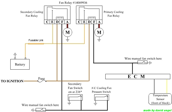

My 30amp 12volt toggle switch for my electric fan has burned up twice now. I thought the one fan wasn't suppose to pull more than 30amps. Do I need a fuse or a relay or something?

when the fans turn on. they will pull alot more amps then when they are running. so everytime u flip the switch......
however u shouldn't wire the fans directly to the switch. u have to use a relay..
note: u will only have one fan and relay since u have TBI..

part # is above in the diagram.. price.. under $20 im sure..

i used all the factory fan setting for the fans, and just wired in a switch onto the fan switch wire and when i flip the toggle switch it grounds the relay and turns my fan on.. alot better than adding another relay and a fuse type switch..
