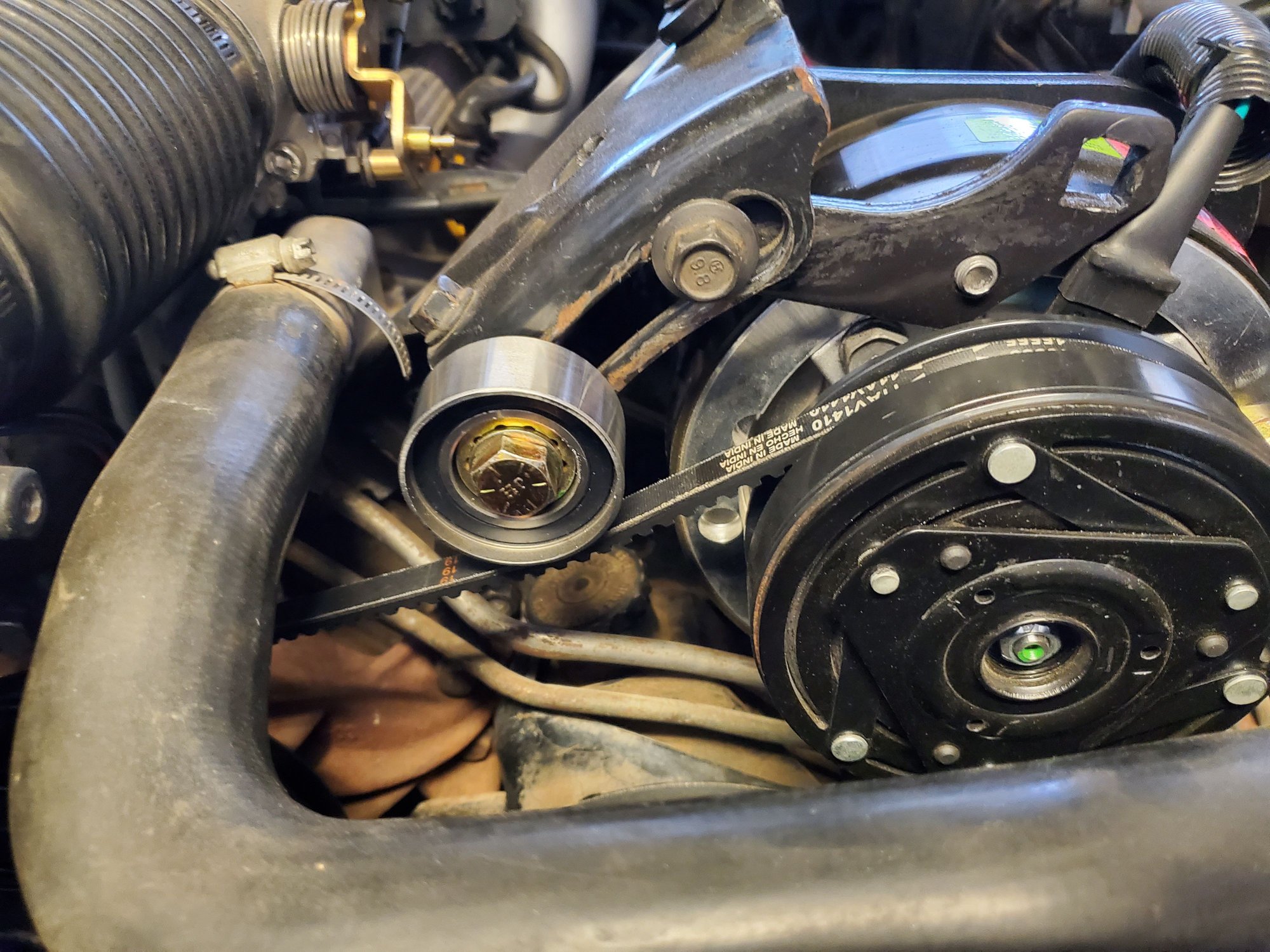

https://nemigaparts.com/cat_spares/e...f/09/mf09-013/
just bought. GM PART NUMBER "10046001" after searching forever

Did it fix the problem?

I had and still have that issue but not really bad before putting a pulley on the upper AC bracket. Still vibrates but not as bad. I will be extending the pulley though with a thingy-ma-jig that I made.

Update on my vibration. I was missing a nut behind the PS Pump. No more vibration!!! Granted that I have an 86 TPI. But the stud behind the pump had no nut. The stud protruded behind one of the brackets. All good now.

Yup, that would certainly make a difference.
