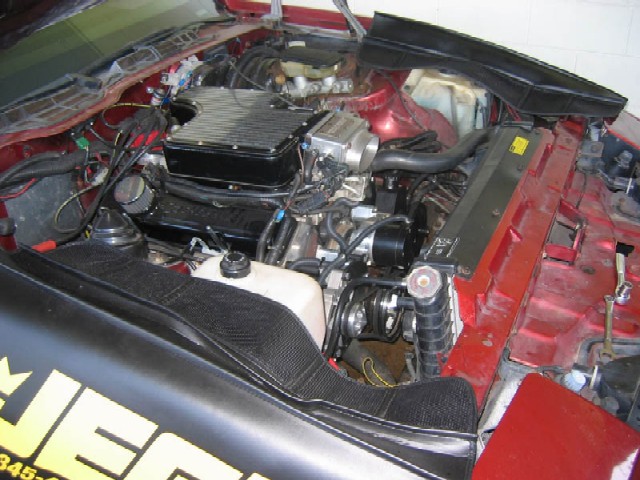

I have done a search on this topic and did not find the info I was looking for. I know a lot of people have asked this question and I am hoping this post will finally answer it.
I have a 1991 formula with the serpentine system. I have already ditched the smog pump and am going to get rid of the A/C this winter. I want to run an eletric water pump, alternator and ps pump only. The question is what do I need and which brackets/belts make it all work?
I am talking regularly available stuff, not March with their $500 setup.
I found these pics on this site of what I am trying to accomplish.
Thanks!

first pic

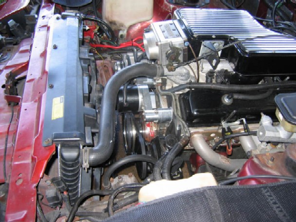

second pic

The powersteering bracket is a stock v belt bracket. You can buy the alt. bracket from summit. its like 70 bucks??? Not to totally sure. Then get some v belt pullies from a bone yard and your set. I have all aluminum ones on my car and I like that but if budget is what your looking for go junk yard shopping.

Hey Fastbird, I don't know if you've found what you need but alan grove has nice, inexpensive brackets for what you wanna do.
www.alangrovecomponents.com
