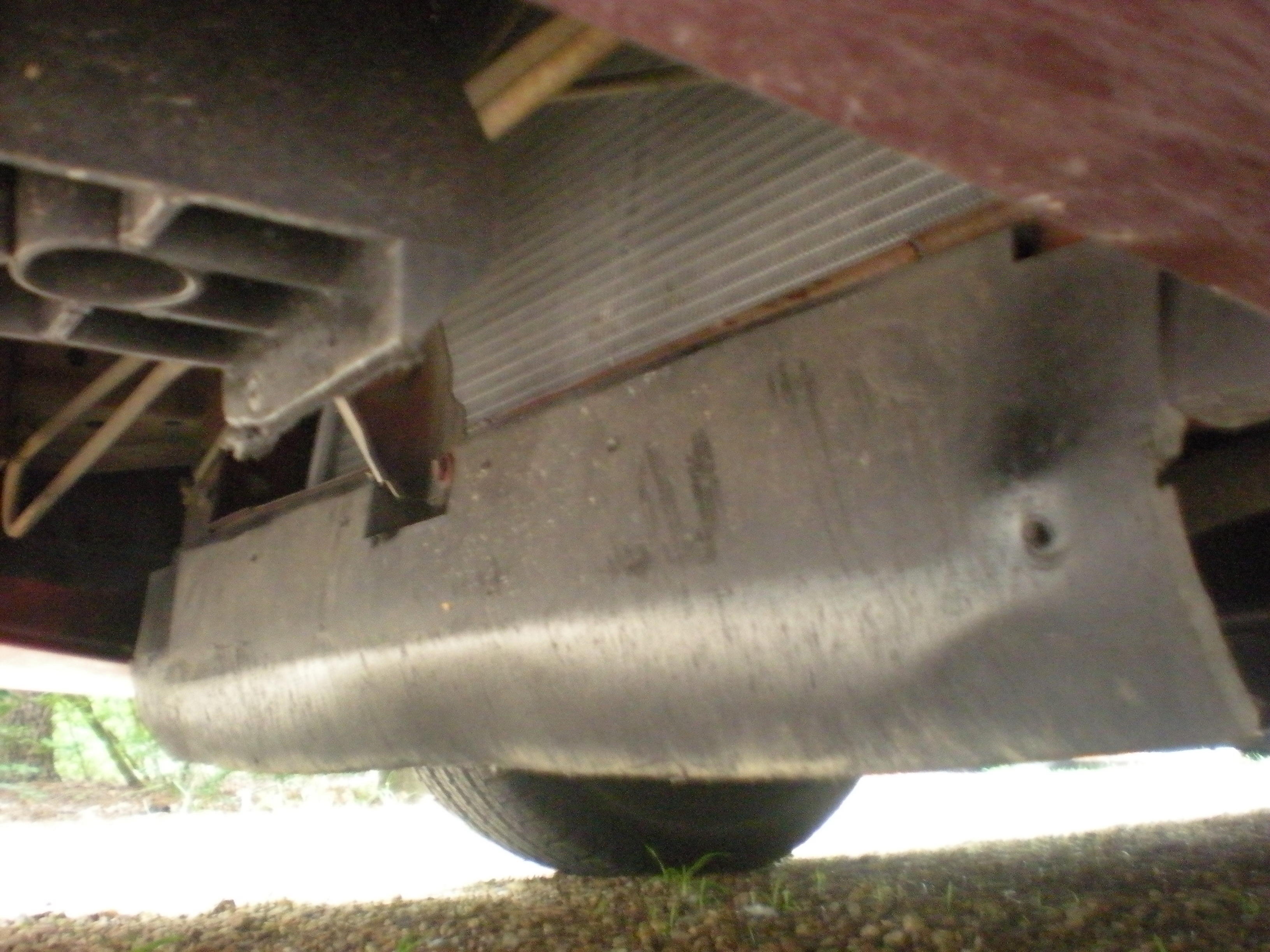

yeah could someone post a pick of what the air dam is supposed to look like?
this is mine, is it wrong? do i need to replace it?
yes you need to peplace it. they are angled slightly forward when right.

Re: dam!!!!!!!!!
yup, thats pretty much what mine looks like , is it supposed to be scooping forward and not backward or whaa? im confused

Re: dam!!!!!!!!!
Looks like somebody removed it at one point, then put it on backwards.
You could try flipping it, side to side.
