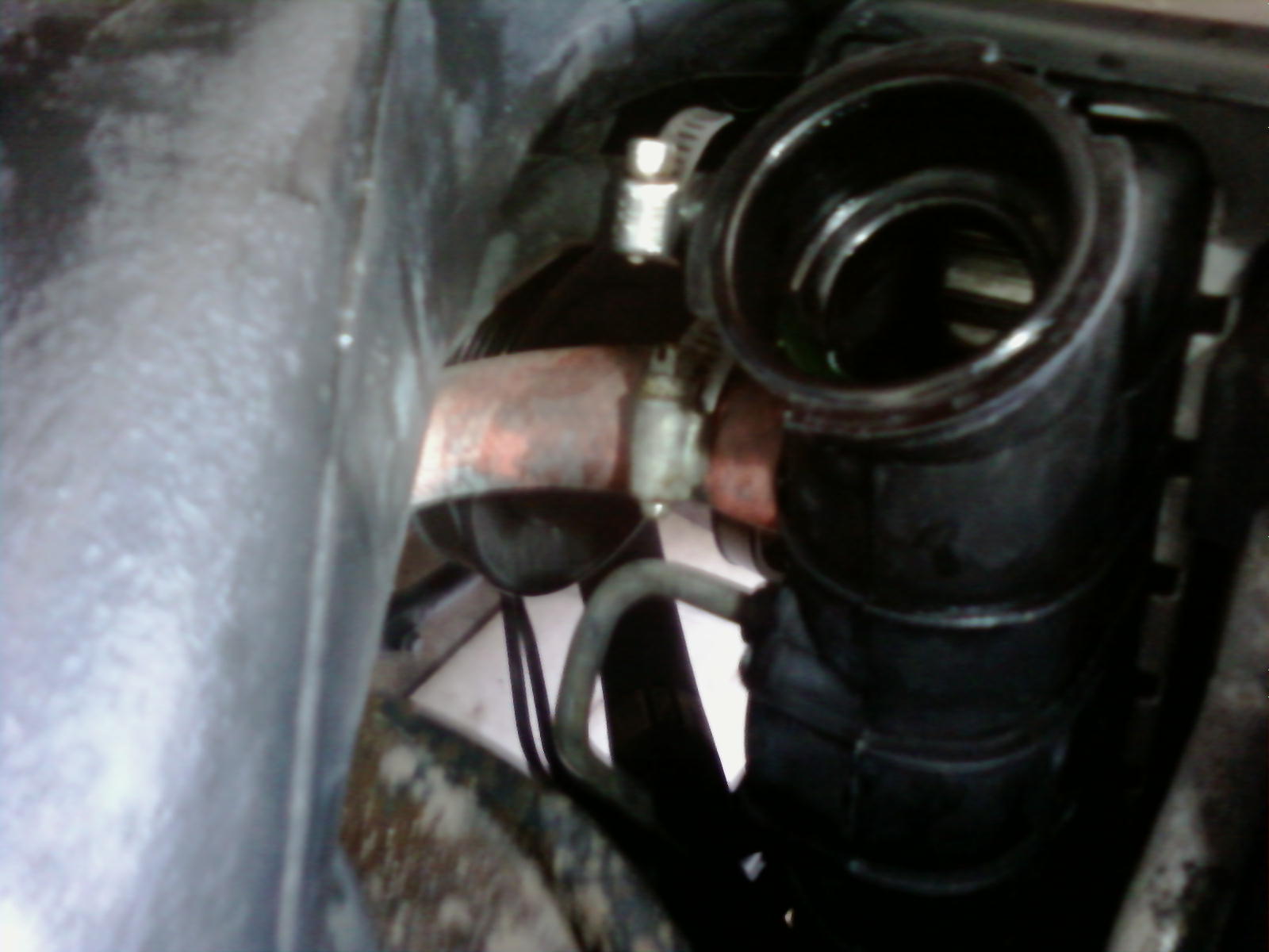

I have no air compressor at my house so no leak down test just yet. Bought one of those combustion testers with the blue fluid and it was pretty much blue the entire time but I think I did suck in a tad bit of coolant so I'm going to test again.
What is this hose?
Goes from under the throttle body to the heater control valve and down to a T where the red hose goes to the radiator and one down under the car
Attached Thumbnails Normal to see bubbling in rad with cap off?-0710011202.jpg   Normal to see bubbling in rad with cap off?-0710011202a.jpg   Normal to see bubbling in rad with cap off?-0710011204.jpg
Old Jul 10, 2011 | 11:37 AM
evilemokid94's Avatar
iTrader: (6)
Joined: Aug 2009
Posts: 3,670
From: Elwood, IN
Car: 1986 camaro Sports Coupe
Engine: L31 350
Transmission: 89 700R4
Axle/Gears: 3.42 gov lock
Re: Normal to see bubbling in rad with cap off?
heater hose and diverter
Old Jul 10, 2011 | 12:28 PM
Mr Froman's Avatar
Joined: Jan 2009
Posts: 611
From: DE
Car: 1990 Firebird Formula
Engine: LB9 - 5.0 TPI
Axle/Gears: 2.73, LSD
Should that red hose be constantly shooting coolant into my rad? It's a steady stream, like a garden hose.
Old Jul 10, 2011 | 02:48 PM
henryd3's Avatar
iTrader: (128)
Joined: Aug 2009
Posts: 1,821
Likes: 41
From: Central California
Car: 92 Camaro RS
Engine: LO3
Axle/Gears: stock
Yes, that's what it's for, it's routing water from the intake that goes either through the heater core or bypasses it and returns to the radiator
