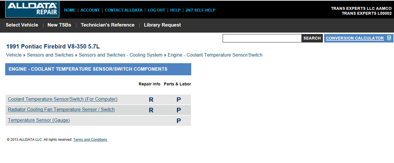

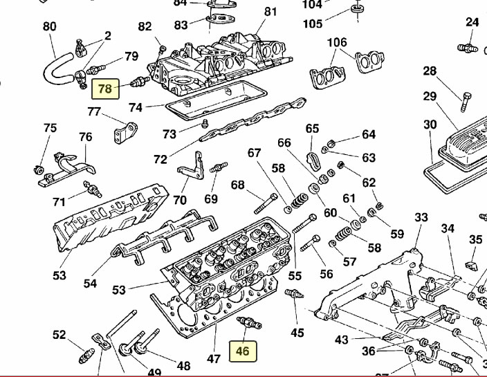

no the engine temp gauge gets its reading from the engine temp sensor in between the 2 front cylinders on the drivers side. that sensor does not touch coolant.
the coolant temp sensor is next to the thermostat in the manifold which does touch coolant but relays that info to the ecm only. you do not see that on your gauges

Old Jun 2, 2013 | 02:21 PM
insomniac's Avatar
Joined: Jul 2010
Posts: 833
Likes: 17
From: The Jersey Shore
Car: 1991 Firebird Convertible
Engine: 5.7 L98
Axle/Gears: 3.45 9 Bolt Posi
Re: Engine Temp Way Higher Then Coolant Temp
all data info. as you can see there are 2 separate sensors
GM Parts Catalog
#78 Coolant Temp Sensor for ECM. Part Number 15326386
#46 Engine Temp Sensor for Gauge. Part Number 08993146
need any more proof?
Old Jun 2, 2013 | 04:37 PM
Posts: 28,022
Likes: 2,496
No, I am not "incorrect". RONG, maybe; just ask my kids; but not "incorrect".
Furthermore, you are 100% INCORRECT on this particular matter.
The parts catalog doesn't show what's behind that hole.
The gauge temp sensor goes into the water jacket, through the 1/8" thick or so outer wall of the jacket, plus the 1/16" or so thick boss around the hole, and right directly into the coolant passage; right between the #1 & #3 cyls. Above the intake valve side of each front-to-rear, but of course over to the spark plug side side-to-side.
If you don't believe me, go pull it out and see what comes out from behind it; then when it finishes draining, look up in there and tell us what you see.
